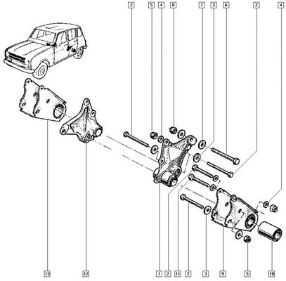

For bushes i have the same problem.
Renault does not give separate part number for it. It goes together with mountings. Number one on the picture below
So i am waiting to dismantle rear axle and measure it
Today I measured mine and found them to match Franzose part number 83033, which is out of stock. I'm going to order part 626057N from Melun Retro Passion instead, because the dimensions are the same except for a longer outside tube. Hopefully this will work!

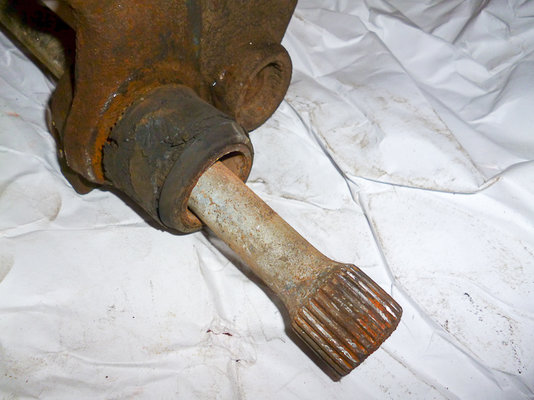

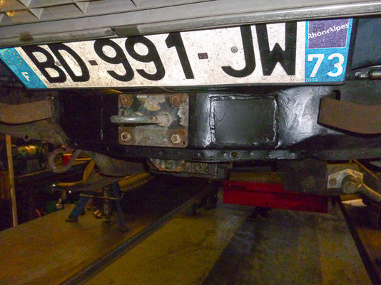

Here's a photo of the newly repaired inner arms and front crossmember, and the remains of the bushings to be removed from the torsion bar mounts.

Can you tell me how did you pull out rear torsion bars?
Apply penetrating oil daily for a week, then hit them with the biggest hammer you can find! Though, as you can see they came out only at the arm ends. I'll let you know how it goes freeing the fixed ends.
The trick on removing the torsion bars is to do what iMac tells us (penetrating fluid and more penetrating fluid), then hit them with that heavy hammer from the suspension arm side, that is like trying to install them in.
This is only needed to get them move a little and make them "wake up". You cannot hit them squarely from the other end because the suspension arm gets in the way. Shock absorbers must be removed, of course, as per the manual.
After the bar moves you can hit it from the inner mounting side, the normal way, to remove them.
For some really stubborn bars, it is helpful to remove two of the inner mounting bolts, so that tension from the rubber bushes is released and no load is placed on the bar splines.
Today we got them properly free at both ends by using an oxyacetylene torch to heat up the mountings. I also removed the remains of the old bushings with a large fly press. I don't know what I'd do without the help of the university technicians and their workshop tools!
