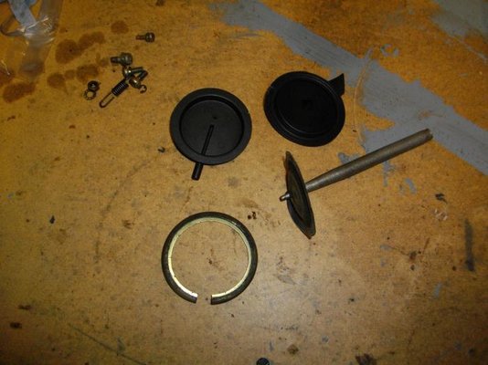

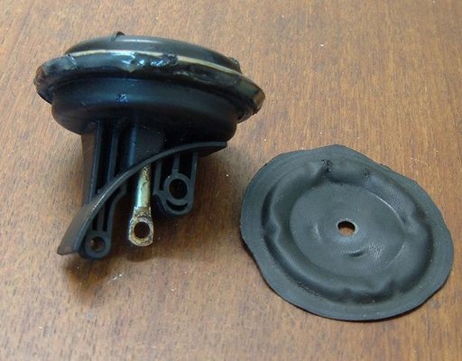

Given Femsa Vacuum advance units are no longer available here's a botch to fix them.
Grind off the metal ring holding the two parts of the advance unit together, and seperate the parts. Cut out a new diaphram from an old bicycle inner tube. Glue the diaphram to the centre plate, then glue the outsides together being careful throughout to avoid any air leaks. This is Robert's botch for today. He used araldite and the vacuum advance seems to work!

Yup, I removed the gubbins from the F6, noting where all the bits went and placing them into a little pot, so not to loose that tiny little spring clip.
Now that the vacuum advance was alone on its own, I took a junior hack saw and very gingerly cut off the metal ring, trying not to damage the plastic unit to much. (a small cut in inevetable)
Using a small stanly blade i parted the two halves of the unit (noting where the metal rod was before hand) And there was the hole, instantly visable. Hooooge!

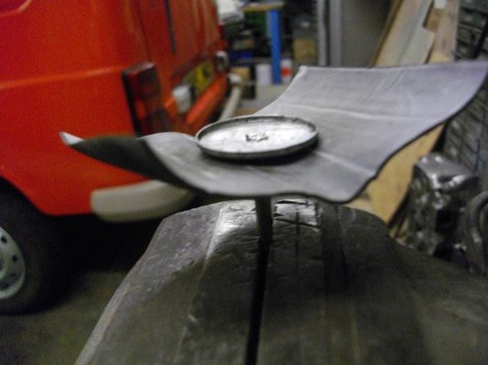

Finding a suitable socket to sit the rod piece in i clamped it in the vice. I very gently then tapped the peened over section on the end of the rod through the outer washer, which ment i was then able to remove the washer and rubber (now plastic advance unit).
I took my inner tube and made the replica replacement. I then had to flatten out the outer washer, refit it and re-peen over the end. (Note: this is quite tricky as the innnertube is thicker but with patience you can do it) Then refit the unit into the plastic half and as i didn't have any sealing materials to hand, I refitted the metal ring.
