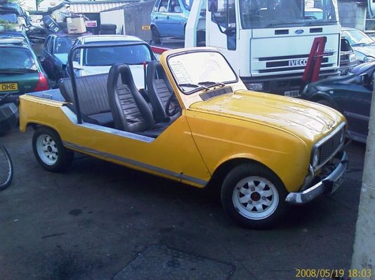

Malcolm did say anything roughly R4 shaped is eligible so weather permitting my Yellow Peril is looking forward to its first trip for 7 years
i have owned it since 1985 ,( it was built 1978 as a LHD 845cc R2109) and having seen Plein Airs in books decided to build my own :) so a week later out came the angle grinder and air hacksaw shortly followed by a 1300 5ts conversion complete with disc front brakes and bigger rears off the 5ts

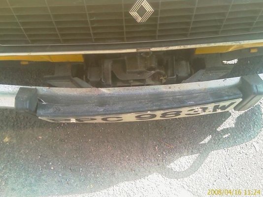

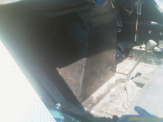

at the time my hobby was banger racing renault 16s so a quick measure up of the engine bay and after removing the central bulkhead area (who needs a heater with no roof ) in went 1647 tx engine bolted to 5 ts box
next problem was steering colum so changed dash to RHD and used R14 steering shaft i also modded 5ts pedals and fitted servo and fuego master cylinder
cant remember exact time scale but 2nd gear synchro was not up to 100 bhp so more measuring and angle grinding and 5 gordini turbo box was bolted to R20 Tl bell housing the whole lot bolted back in and even hides behind original chrome bumper

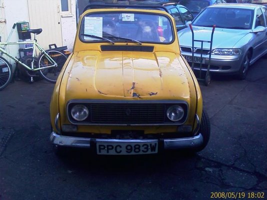

at this point decided on respray think it was 1993 ? and the chassis and floor pan were rustfree and original apart from reinforcing members welded in to restore strength --link to older photos http://www.renault4.plus.com/gallery/peoplespics/PPb/PP12.htm (on another site b4 i found this one sorry malcolm)
fast forward a few years of summer use and moisture has crept into normal places and now looking a little sad so as i cant weld :( it went no where until 2002 when i parked it in my workshop and cut out and made some repair sections and got a friend to weld it all up for me by then it was end of summer and lost interest

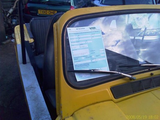

now thanks to the inspiration of this web site and some sunshine i have got a new mot after a small amount of work :D

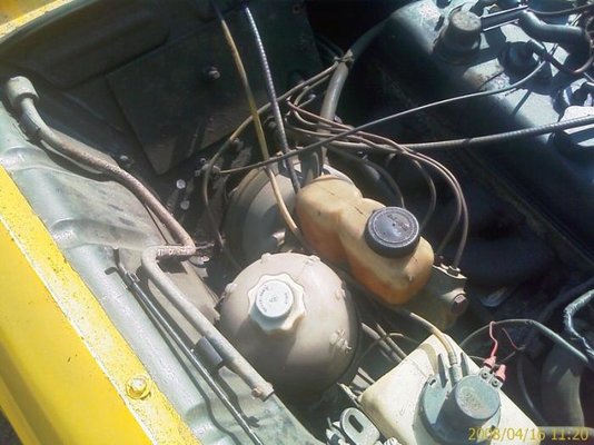

problem 1 was getting a a short distance and then no power under load ,made it back to workshop to discover problem 2 water leaking from pump :mad:
solved no 1 as remembered reading on here about filter on fuel pickup in tank , getting hold of a now obselete renault 16tx water pump was more of a problem :confused:
typing in QH number into google came up with Speedy Spares (local to me) who had 15 in stock !!
have been and collected boot floor for malcolm and a few boxes of R4 goodies so provided the water pump bolts dont shear off it should be sorted today
