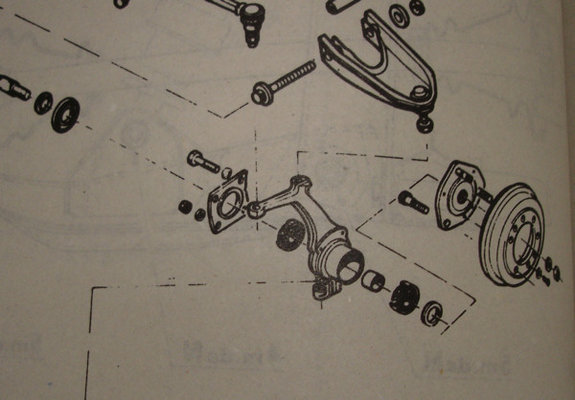

I have an R4 parts catalogue, P.R.1104 for 1985. It seems to me that there is only one set of bearings for both drum and disc braked axles. They are a pair. The outer bearing part number is 7703090270, the inner 07703090271. They appear to be equal dimensions, at 30x62x16, and were available as a complete set, including grease, as number7701460637. Looking at the drawing, it looks as though the rubber flange is set innermost. I would suggest you go in to your local bearing suppliers, and ask if they have them on the shelf or in their catalogue.

Here's what the M.R. sais...
Seems that there has to be one washer on both outsides of the bearing-assembly. (One facing the wheel, one facing the driveshaft.)
And apparantly depending on the bearing that is mounted on the inside (with or without lip on it's flange) the size/thickness of the inner washer variies...

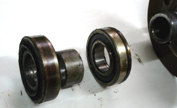

These are the bearings I removed on the left axle.
Both Bearings are "closed" ones
One washer on the outside (facing the wheel, damaged now :()
Inner bearing with "lip" on it's flange (facing driveshaft)
Outer bearing with seal on it's outside ring

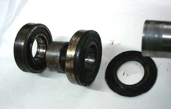

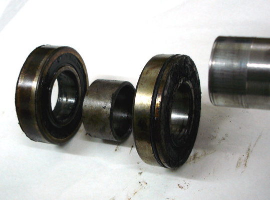

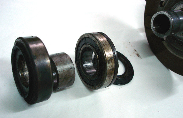

These are the bearings I removed on the right axle.
No washer on the outside here

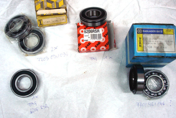

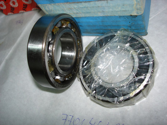

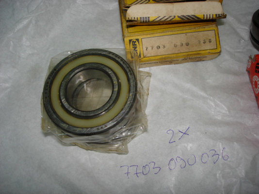

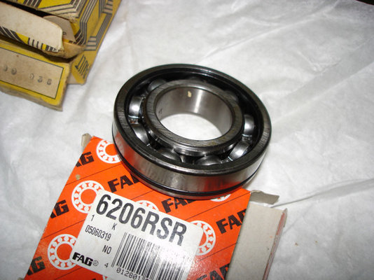

And here are the new bearings I have ...
2x Renault 7703090036 (both sides "closed", seal on outside ring)
FAG 6206 (one side "open", one side "closed", seal on outside ring)
FAG 6206.2RSR (both sides "closed")
SKF 18E1373 (?) (one side "open", one side "closed", lip on flange)
SKF 6206 (one side "open", one side "closed")
All the bearings have matching diameters/sizes, I'm just totally confused with the lip/no lip, seal/no seal, and open/closed thing...
If anybody could help... :rolleyes:
Thanks in advance!
David

Hi there,
I have a question regarding the washer that was mounted on one side of my front axle.
It has a inner ring, made out of brass and an outer Ring out of simple sheet metal. The outer Ring is damaged now (bent).
The M.R. sais that it is to eliminate a creaking noise/sound when starting to drive.
I don't know where to get such washers and wondering if I just could mount the bearings without a washer.
Would that do any harm?
As far as that "problem" is not solved my front axle will have to stay that way and I'm kind of stuck...
Thanks for your help!!!
David
The "factory spec" bearings were open on their inner sodes, to allow the inner space between them to be filled with grease (for better lubrication?) . I guess that the o-ring in the groove on their outer ring was to eliminate the slight possibility of moisture getting in / grease getting out between the outer rings and stub axle carrier. But since the bearings are a press fit on the stub axle carriers, this should not happen...
My experience with various bearing types I have used...
The SKF kit vlk describes is the most convenient to uses since it contains all you need in one box, no need to order two or three parts. Also, one bearing on this kit has a special outer seal (to be located closest to the driveshaft), to protect the bearings better.
The o-ring around the outer ring is not standard on all bearings.
There is absolutely no difference in perfomance/reliability if you fit two standard bearings, with both sides sealed, or if you remove the two inner seals and fill the space with grease.
The bearing fit must be relatively tight in the stub axle carrier housings. If you can push them in by hand pressure (not uncommon on high mileage R4s), the fit is not correct and there may be play on the wheel even though the bearings are new. In this case, degrease the bearing outer ring and its bore and apply some bearing retaining compound (similar to thread locking compound but thicker).
There is no difference whether you fit or not the "anti-squeak" copper washer between the driveshaft and the hub.
