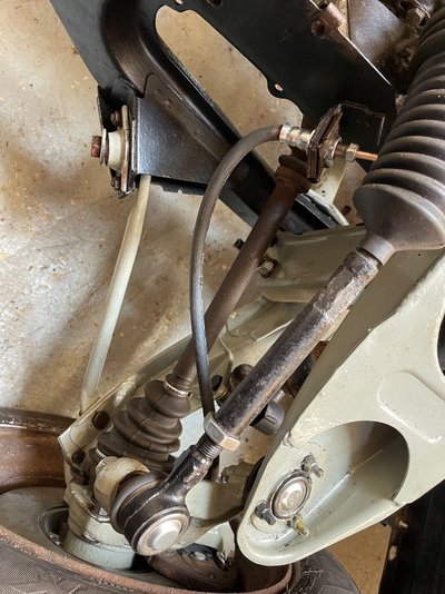

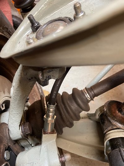

I have fitted new hoses sourced from AUTODOC using the correct Renault part number. They look far too tight and could do with being maybe 50mm longer. AUTODOC describe them as “430 mm”. Can anyone tell me the correct length?

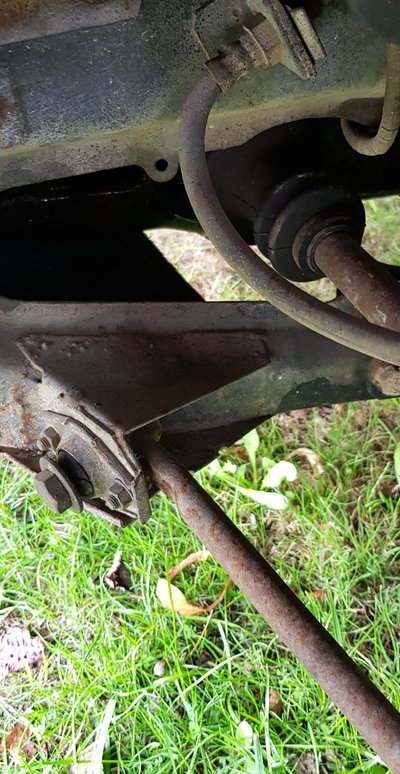

Could you post a photo of your hose/caliper set-up?

The front wheels are in the normal driving position. I have tried to measure the length of the hose and appears that they are 430mm total length. It is the chassis bracket end that looks uncomfortable.

I don't know whether this helps at all, but here's a shot of the N/S hose in my F6:

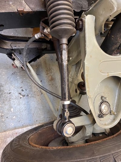

I just fitted the 502mm hose. Shown in the right. It is a much more comfortable path than the 430mm on the left. It remains an easy path in full steering lock. An ideal would be around the 480mm mark

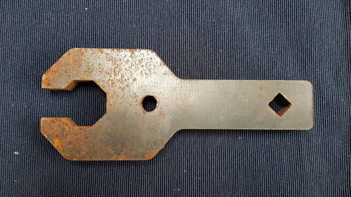

Also, the front torsion bars are not equally tensioned yet. Now that I have everything assembled, the proper tension relief tool would be the safest thing g to use. Does anyone have one that I could borrow or hire?
I don't have the complete tool, but have got this - you're welcome to borrow it if it's any use:
