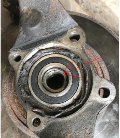

Do you think it was a good time to start fiddling with front wheel bearing 4 days before heading off to France and Thenay?
I know the answer.
Anyway im in too far now.
I am trying to push the very inner bit(red arrow) through with a threelegged puller to the other side. Im worried i shouldnt. see photo
im tring to change the bearings
Any help appreciated, whay do i do it to myself

Find an old socket you dont use any more and using voliunteer with gloves to hold hub hit with copper hammer not too tight so faiely sinple
Next game is getting the outer bearing off of the drive flange thin jaws on puller needed
Fantastique........I am doing it right. ok onwards and upwards and I will post phots. Thanks Mr Reno and Jurjenz
