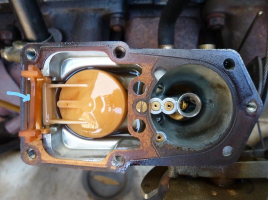

What's the number on the side of your carb?
I ask because it can affect the float setting - on some 28IFs (like the one below), the setting is 8.9mm rather than 8.4mm. What setting did your manual give?
If you do go for a new (perhaps remanufactured...) or secondhand carb, it's important that the specification is right.
V05 079
The nearest carb ref in our manual is V05 078, which gives a measurement of 8.9mm and that’s what it is set to and it’s what it was set to.
