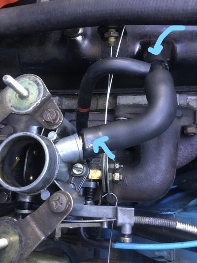

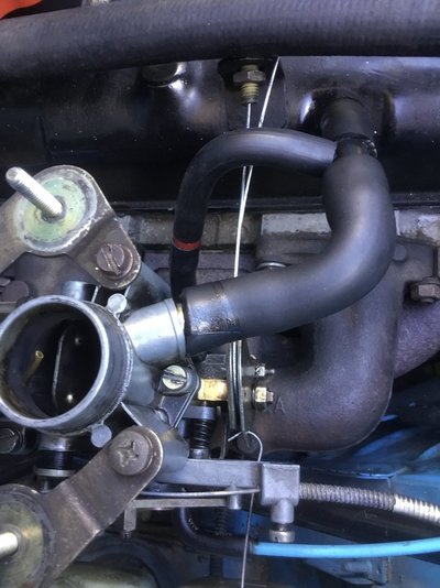

- As jcarruthers2 mentions above, it's critical to ensure that the arrowed pipe/restrictor/manifold connection/rocker cover are really clean (it looks as though your car - and perhaps all Portuguese GTLs - has a different restrictor system; on UK cars/vans the restrictor is in the pipe):

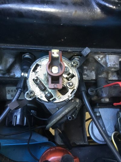

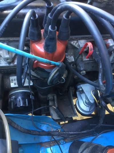

Could you post a few photos of your carb/distributor area?

re the distributor: what make is it? And how do I approach changing the points? Not come across one before with a metal plate.

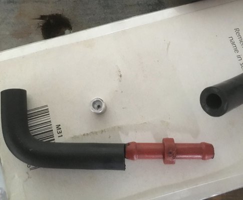

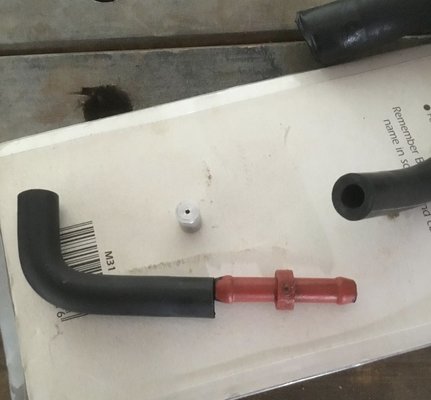

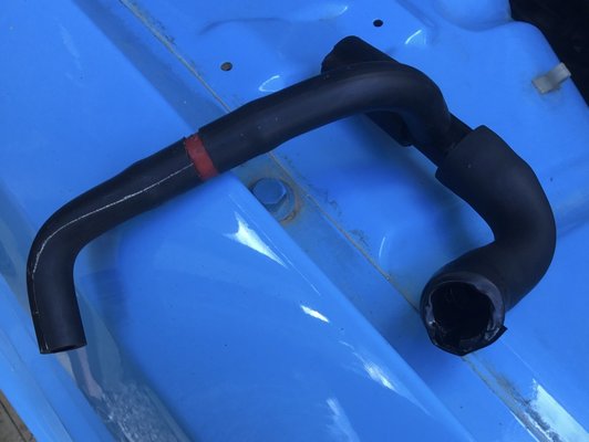

the restrictor photos - the red one is what‘s on it and the silver one is what I received when I ordered one.

It's a Femsa distributor - points maintenance/changing is much more of a hassle than with Ducelliers. There's an excellent page on them here:
Changing Distributor Contact Points (renault4.co.uk)

Just a thought, and just checking - cylinder 1 is the one nearest the water pump (in your photo with the distributor cap off, the rotor arm is pointing at cylinder 4).

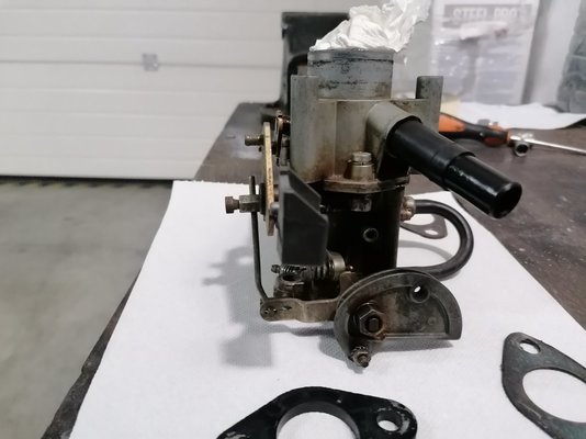

The carb is clean and ‘seems’ to be working ok and all the movable parts are doing what they should be doing, but the fact remains that the car won’t run and I keep coming back to the fact that there is fuel starvation.
I’m thinking of buying a new carb.
Plus also thinking can I do away with the air restrictor and just have a straight tube like on the U.K. engines? I bought a new restrictor and the car runs worse than with the old one.

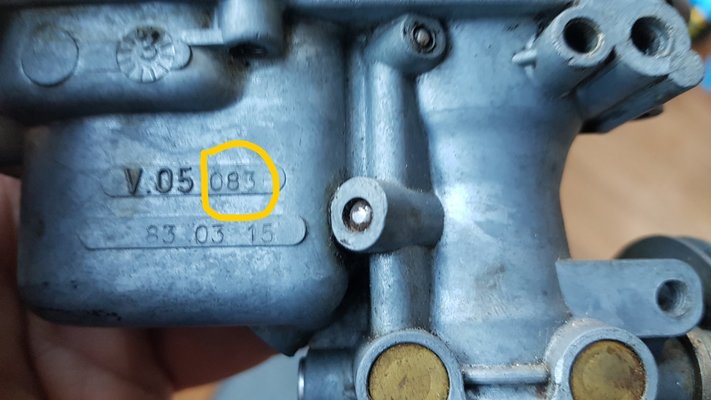

What's the number on the side of your carb?
I ask because it can affect the float setting - on some 28IFs (like the one below), the setting is 8.9mm rather than 8.4mm. What setting did your manual give?
If you do go for a new (perhaps remanufactured...) or secondhand carb, it's important that the specification is right.
