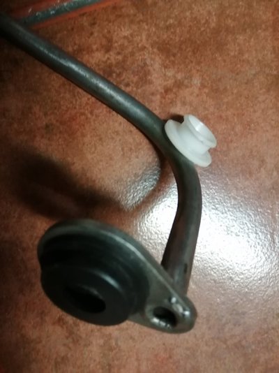

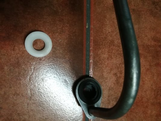

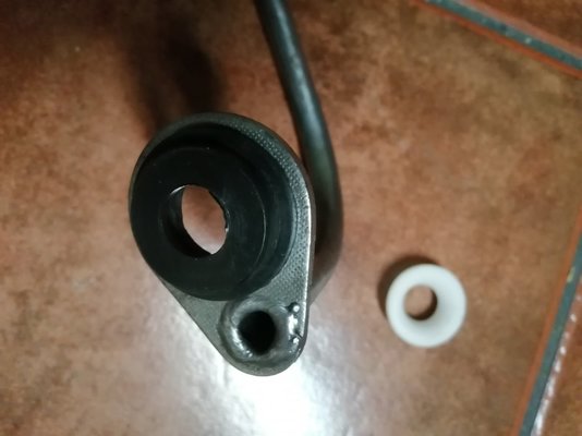

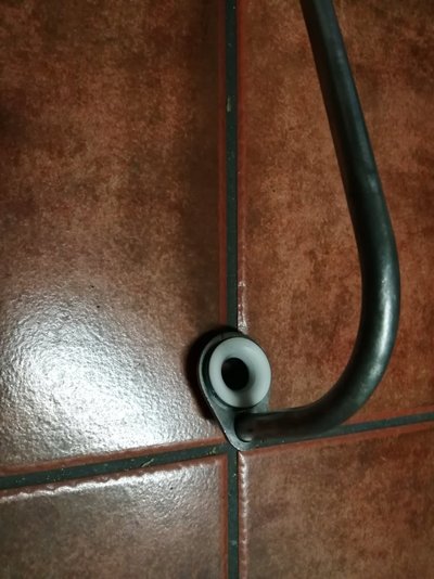

Ok, guys... job done!
This nylon bush is larger than the original one... so after fitting it to the rubber mounting, the assembly had to be mounted on the lever from the top.
Heated the rubber and with the help of a small screw driver I managed to push the hole thing in to place. Not an easy job, though! And it's easy to damage the rubber lip. Nevertheless, it's in position.
Thanks again, to all of you, for you tips.

Hi Ricardo
I'm glad you have been able to fit it. This aftermarket bush looks quite different to the original, I have seen these advertised somewhere but as they are different to the originals, I was wondering if you have noticed any change in the smoothness of the gear change with this type of bush?
Any info will be greatly appreciated.

Hi, Chris!
I'll say something as soon as I test it.
I suspect that this is an attempt to solve the problem Simon mentioned. Hence the upper face of the nylon bush being larger than the original.
Best regards.
