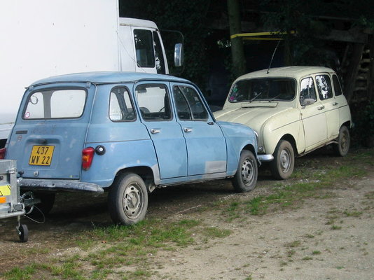

So have added my 2 recent restorations projects cars
The blue one only needs new front wings to put back on the road and maybe a better way to tie the battery down It is a bit of string at the moment

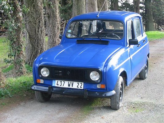

The blue car is now finsihed and the CT completed
I have painted it in a nice shade of blue brush painted but looks Ok The car is not a museum piece but a car to use every day for local runs
Have updated the picture

It looks great! I think the black bumpers look cool
I wish R4s were so easily available here,
