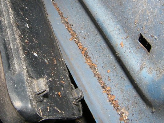

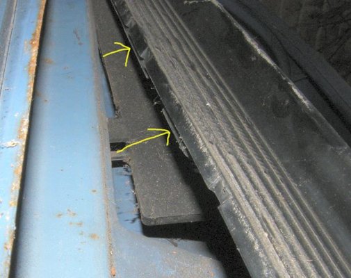

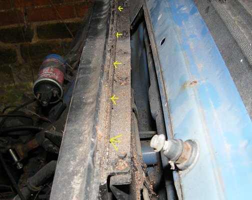

Can anyone tell me how to remove the black plastic air intake grill just below the windscreen on a GTL.
I want to remove for painting the body.
gary
can someone tell me how to put it back on afterwards cos ive been trying for ages......
First remove the 4 screws.
The grill will still be held in place by a plastic tab running all the way along the top, and a similar tab at the bottom.
Try pushing the grill upwards from the bottom to remove the bottom tabs. If that doesn't work locally push the grill to remove the centre tab, then use a bit of wood to press upwards at the awkward tabs at the edges of the opening.
Once the tab is removed on one edge the other will be easier. Cleaning the gap behind the top might allow more movement.
Refitting is the reverse of dismantling. :hug:
