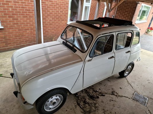

So,
I made up a blanking plate below the fuel pump. that is sorted. Then I bled the rear brakes with some weight on the rear wheel, brakes now feel OK.
I blanked off a vacuum hole in the inlet manifold that was sucking in air and set the timing. Does that mean it is from a car with a servo?
Screwed in the dash plastics and shelf (binnacle surround and steering column cowl). They are knackered and need replacing ideally.
I fitted one of those new £70 carbs on Ebay that look a bit like a Solex item with an accelerator pump. Seems to work well. Smooth idle and good acceleration. I know it says £109, but for some reason I got a discount. Dont ask me how.
Fitted the blower motor housing, I need a nob for the water valve.
Noticed the alternator was out of alignment, so I adjusted the lower bracket and the belt seemed happier.
Then I took her for a ride around the yard.
Drives very well, feels nice and tight with new suspension bushes, tyres etc.
No leaks. Throttle cable needs replacing or lubricating. Bit sticky.
The folding roof works very well.
But, air bubbles are coming up through the expansion bottle.
I bled the cooling system using the heater bulkhead valve.
Head gasket? If the consensus is yes, I will whip the head off tomorrow am.
