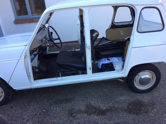

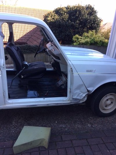

Edwin. Good to hear your floor pan from Franzoise was a success! I thought I had a small hole in the floor but decided to clean the whole floor off with the result I now have dozens of small holes all over the place and a new floor pan seems to be the answer. This is part of a larger project which started with a person hitting the car last June and is an on going saga. I was pondering over the centre rail and according to Geoff in the Gully he cut the old floor out either side of the centre flange then welded the new floor to it. Do you know if this what your welder did?

The holes I had were in the front foot well on both sides, rusting from inside out. As you said, not apparent until you start a spring clean of the car floor. I only really noticed the extent when I went to the car at night to collect something and noticed the torch light shining up through the floor.
Looks like a nice car. Mine looks similar, light dash, mine has hammock seats, 1972 1126 with 782cc motor. Having trouble finding time to get mine done.
