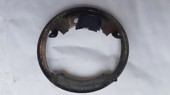

Hi All, I have just bought a NOS headlight and the plastic slider that changes it between LHD & RHD is missing. The slot it fits in is there, was this a separate item? Does anyone have one, or an old headlight I could dismantle please?
Chees Simon.

My sliders are on the housing that is riveted into the bonnet, and tilt the inner fitting

I have an H4 headlight that I can’t find a matching second one for. It still has the adjuster on it. I think.
And I might have some bad ones with adjuster. I have to dig into my spares.
I’ll let you know on Thursday.

Hi Simon, I've an idea you don't necessarily need the slider, as once the bulb is retained by the two spring clips it can't move, so just experimenting with bulb position should work. Looking at the hole the bulb goes into as a clock face, the tag on the bulb goes 7 oclock for UK driving and 5 oclock for the continent or thereabouts. Regards Brian.
