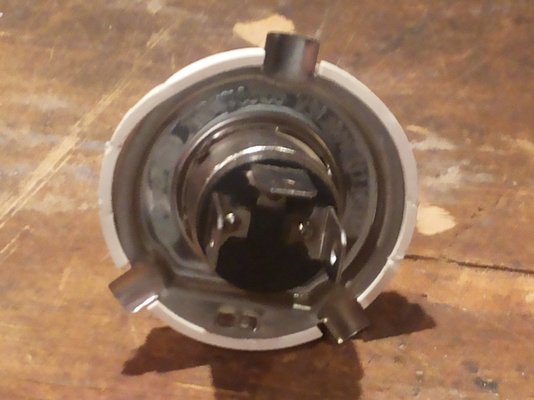

Here is one internet photo of different bases,

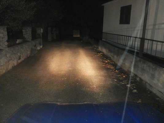

In addition to my previous post and center of the focus in headlight will put few pictures to see what i was talking about.

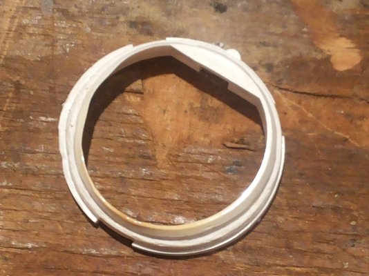

I have bought adapters for H4 bulbs (P43t base) to fit R4 headlights.

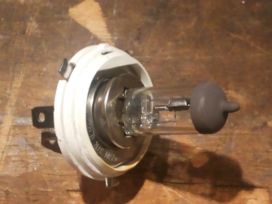

Adapters look like this.
Adapter with H4 bulb and P43t base

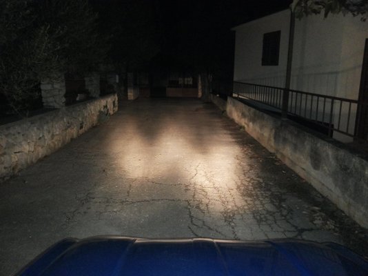

And with them you get this kind of illumination on the road
You can see two big black spots in the middle of lights.
Here is illumination made by H4 bulb with round base (p45t)
Spot the differance....
