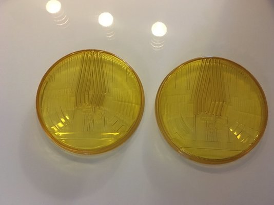

So an interesting day... I thought I had old bulbs in my motor but I don't on looking closely i have the ones like listed on retro car parts with the glass caps. So for now I have removed the yellow caps to see how it looks tonight, I think the main issue I have is that my daily motor has bi xenon and my wife's Led headlamps so I need to get used to less light than on a new car

So after removing the yellow caps and adjusting the beam on the front last night all looks better, so it's now got the 60/55 halogen bulb with the yellow caps stored for future use should I wish.. White for driving along dark lanes and roads where I live worked well last night with no issues. Managed about 40 miles last night and all was good :-) even managed to find the smallest parking spot in the pub to slot into.
