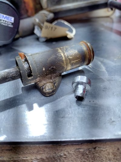

Finally managed to get this done. It turned into quite a palaver.....When removing the tap from the rad one of the studs sheared off half way then when trying to unscrew the retaining screw on the tap that sheared off too. First we replaced the retaining screw by drilling a 2mm hole and superglue-ing in piece of 1mm copper cable core with the insulation still on it. The stud was more involved; we took an 8mm bolt, drilled it through, tapped a 5mm thread, rounded off the nut, cut a slot and finally having drilled out the tap fitting as much we dared, ground off the thread on the 8mm bolt. Quicker to buy a rad and tap from a scrap dealer, yes but not as much fun.
