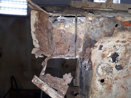

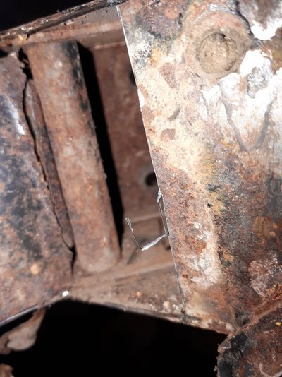

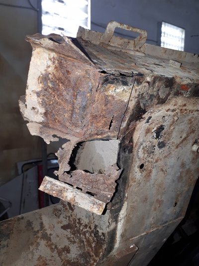

Anyone has pics of a repair on this rear section.Thanks

That is rear side of side crosmember?
I have some ACAD drawings for it.
Can send it to you earliest tomorrow during morning.
Give me email where to send it.
I did it my own way - https://www.renault4.co.uk/gordini-outerrrsusp.htm The outer rear suspension mounting has a complicated construction. You can get repair sections where you cut the old one off and weld a new one onto the chassis rails.
The rear suspension is very sensitive to accurate hole positions. Inners for height and outers for fore-aft. After messing a couple of them up I made a jig. https://www.renault4.co.uk/suspension-jig.htm
Thanks for your help!
Thanks a lot have figured it out but no harm in having the design, will send you my email.Thanks a lot

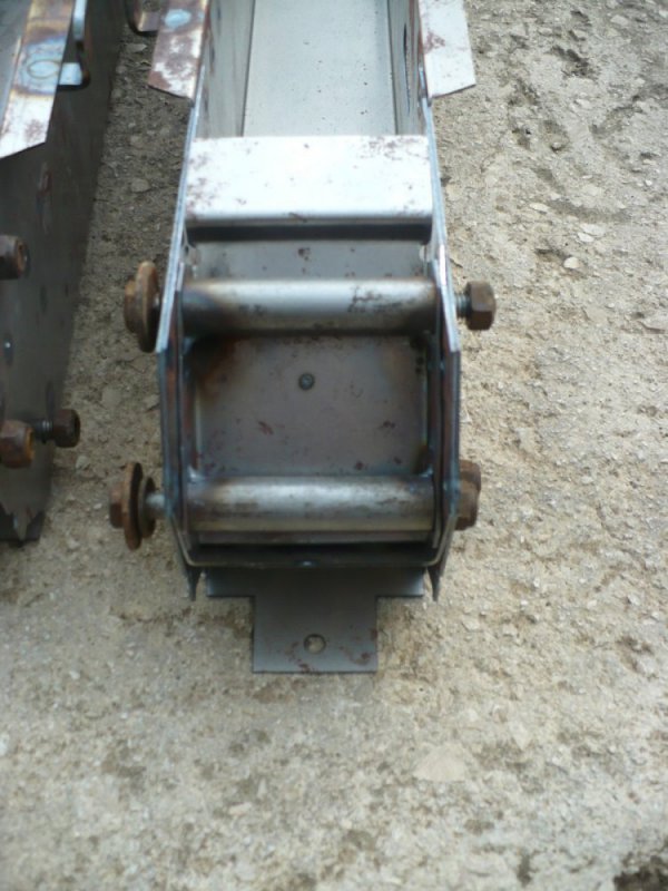

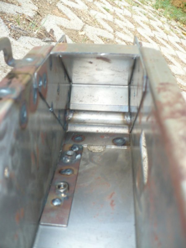

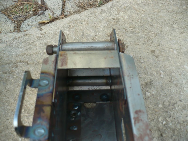

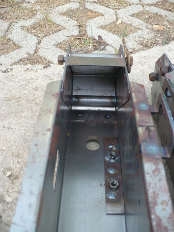

Can make side crossmemebers and rear crossmembers from plain sheet of metal.
CAD drawing, laser cutting, bending and spot welding.
You get finished product that need to be welded to chassis and protected from rust.
More can be seen at second page of my topic about blue R4
