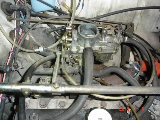

Looking for the 2 water hoses to the base of the Zenith 32IF 7 as shown in attached picture.
These seem to be preformed and I have looked on MRP & Der Franzose sites for replacements to no avail.
Do I just use straight hose as best I can? Any comments appreciated. Thanks

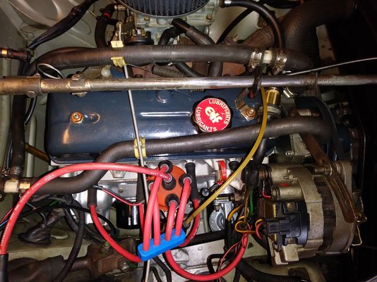

Hi Tom, I reckon the hoses you are looking for are unobtainable now, so I simply tee'd into the heater-hoses, which works very well. These plastic T fittings came from a company called Car Buider Solutions.
The heater hoses on my carb. Are pneumatic oil hoses. Work fine and are super strong.
Regards Brian View attachment 22870

Thank you for confirming what I suspected.
Have used CBS many times in the past so will browse their site.

Hi Tom. It's a while ago I bought these tee fittings, and now I'm not so sure I got them from CBS, sorry, so I'll try to track down where they came from. Oh the joys of getting older :(
Ah ha, I've found the suppliers, it's AFS, Advanced Fluid Solutions.
Regards Brian.

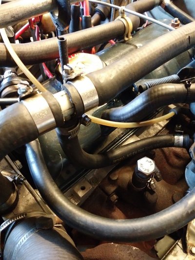

Oh dear, and I thought it was only one :laughing: The tee pieces I used were 18mm with 10mm take offs. Two more photos to show a bit clearer the set-up.
