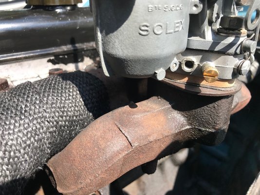

(1) I wrapped the exhaust manifolds in insulating webbing (bought my the metre from Think Automotive) attached with some stainless cable ties.
(2) I put a 6mm phenolic spacer between the inlet manifold and the carb. I couldn't find an exact one for my Solex but found an Amal carb spacer and gaskets from Burlen Fuel systems that needed 20-minutes of reworking to take the internal diameter out a couple of mm.

722stu, be aware that it's not recommended to wrap a cast iron manifold, it may crack.
"722stu, be aware that it's not recommended to wrap a cast iron manifold, it may crack."
Yikes... no I hadn't considered that. Good advice, let me see how I get on with the spacer alone! I'm guessing there's no issue to wrap the exhaust downstream of the junction with the manifold if this contributes to keeping the carb a little cooler?
The phenolic spacer is really important. They had them fitted when new but you often find on older cars they have gone missing or just replaced with a normal gasket and nothing else. I had same problem, correct spacer was missing, cut one out of 6mm phenolic sheet. This has so far worked fine but if it still didn't I would have made another one from 8mm sheet, provided I had enough stud length remaining for the nuts. Having said that 6mm was fine and the problem went away.
