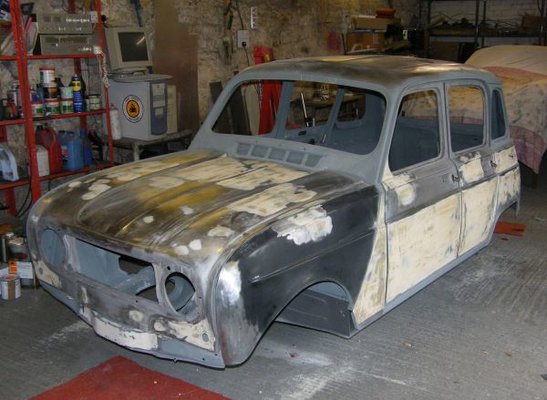

My Renault 4 project is nearing paint. Just a little more panel alignment and I'll go for some paint:

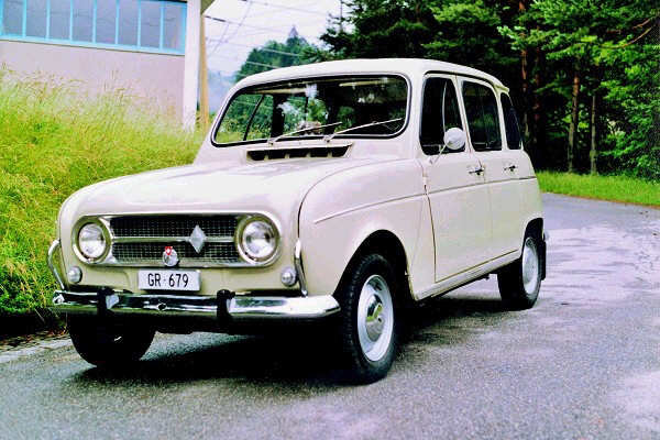

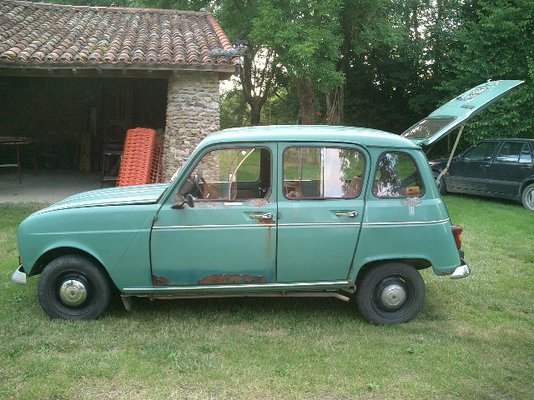

The wheels are a problem - with 3 times the power the standard wheels just aren't wide enough. I can get a little wider with the Spanish GTL wheels (normal GTL wheels with the early hub caps), but a little wider still would be sensible. I'm thinking something like this:
Perhaps with the paint in a slightly lighter shade. I like the light creme - it's a summer colour for me.
Something more like the photo I pinched from http://www.geocities.com/richardirl/52.htm but not quite so pink (I'm sure that's the camera).
So to end the preamble - What does anyone suggest for happy summer creme paint codes? What would you recommend? And what about the wheels - will the Gordini wheels be too ghastly? Every other part inside and outside will be a mix of 1967 and 1968 model years. I'd hate to spoil the effect with '84 R5 wheels, but I'm struggling for rim width. Anyone have suggestions for a colour for them to hide them a little?

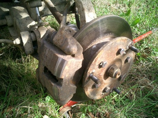

I don't really like the Gordini wheels on an early 4 either. The original wheels won't fit because of the disc brakes, otherwise I'd certainly widen those. (Checked again tonight - they'd need somewhere between 12mm and 25mm wheel spacers to clear the brake callipers.)
There's wheel fitted to the spanish cars that's like a GTL wheel with a hubcap which I could possibly widen -
From French Four's album:
Renospeed (who has the same trouble) uses late R5 pressed steel wheels, but I'm not a fan of those. I'm tempted to try some really grippy 145 tyres. :D

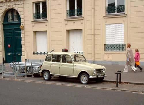

The blue, the red or the yellow one, or is it the primrose colour on the Fiat 600?
I've decided on cream I think (though the yellow fiat is rather fetching). Fixated by the wheels now - which do you reckon would suit an early creme Renault 4 the best?

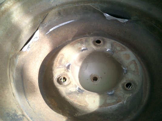

Barbara (WinterSpirit) must be the one in the world having old style wheels with drum brakes! A bodyworker who was assembling her R4 after respray noticed they will not fit, so his solution was a big hammer on the inside of the slots...and voila! Amazing enough, these wheels had no problem being balanced later....

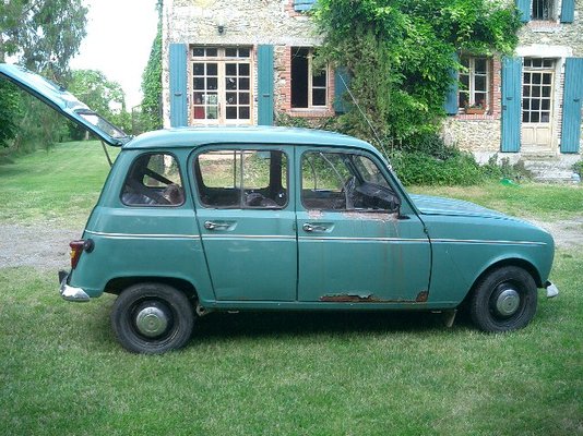

..But, and this is a gigantic but..

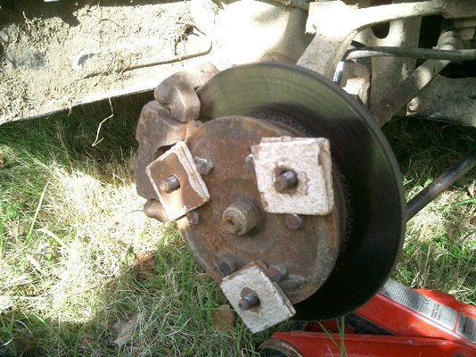

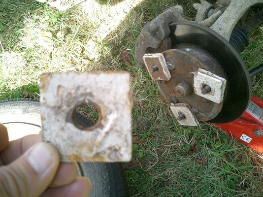

..I now agree with your suggestion Malcolm that a front wheel from a Green 1980 Type R1126 Renault 4 with drum brakes and front handbrake will not fit onto a Blue 1984 disc braked Renault 4 Type - O - Graphical / Error and the first photos show what enormous, (and when I say enormous I mean enormous) damage can be done to the caliper and the internal rim of the wheel but, and this is a mamoth but, if you look in the Renault 4 Spares list 1978 - 1988, part number CS/1216-422G/USB-747-iPod-UB40/U2 - 1066, is a special spacer piece made specifically for mounting old wheels onto new cars - They fit very neatly in between the holding together wheel bolts and cost 6 euros plus tva each and are available at all the 4 Good Renault shops here in France. I even have some spares that I may pop up on Ebay unless anyone wants some?
So, and this is an enormous so Malcolm dear boy, problem solved.
So, and this is not such a big so, the future is bright wheels and the future is black wheels..

Which car is Barbaras? Would certainly reduce the size of wheel spacers needed if those indents were ground off (as Ian has done). Though look at the dents in Ian's wheel caused by the bolts that hold the discs. More trouble. If the wheel sits on the bolts that's not a good thing as the nuts will have nothing to tighten against (well done Ian for posting the photo - I've learned much).

Obviously these spacers are too thick. I would think twice before putting any sort of track extension on a R4 as altering the offset puts major stress on front suspension components, not to mention that they spoil the already well laid out suspension geometry of our cars.

going back to the depths of my past experience pretty sure that if you use bendix caliper setup and countersink drive flange bolts that hold discs on there is just ! clearance for drum brake type rims

Bendix brakes are a lot more compact - thanks Mr Reno. I've just tried one on a hub with the disc screws removed and the early wheel goes around (with the odd little scrape - would have to fettle the vent holes in the wheel a little).

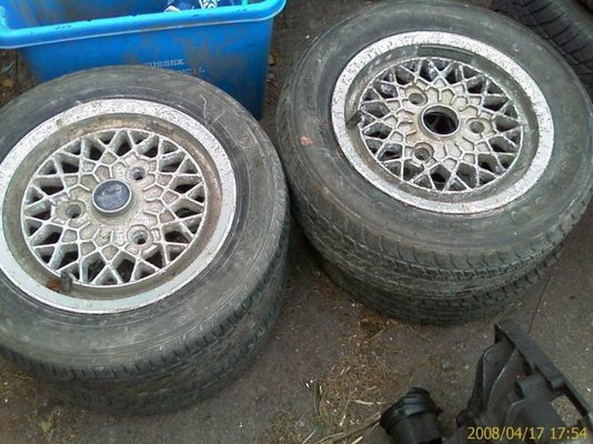

I don't suppose anyone knows of a car with that style of wheel in 4.5 inch width? Otherwise I'm tempted to go with the early rims and some decent quaility 145 tyres.
hi allan, (and every body else )
id thought about rostyles but think they are possibly wrong for a (visually) mid 60s R4
we never got them over here but believe 90s french Clan models used them

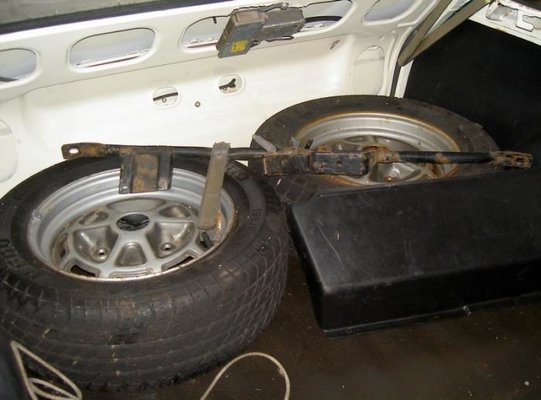

5 Le Car turbos used these in 1984/5 - wider than standard 5
pic below shows 2 sitting in back of Gordini powered R6 in the famous barn :roll:
