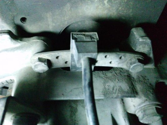

I have had some experience with this issue sometimes solved by a carburetor cleaning and tunning on a R5 (Points) and an Alliance (Electronic), I may say it is something to check in the first place.
But if it does not work, regarding moving the advance, On the Alliance car the pick up sensor is attached in front of the flywheel and seems to be movable to advance or retard the signal. See attached picture. It is not done moving the distributor shaft.
Locally here some people has adjusted it that way. Chances are it may apply to your R5.
