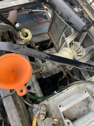

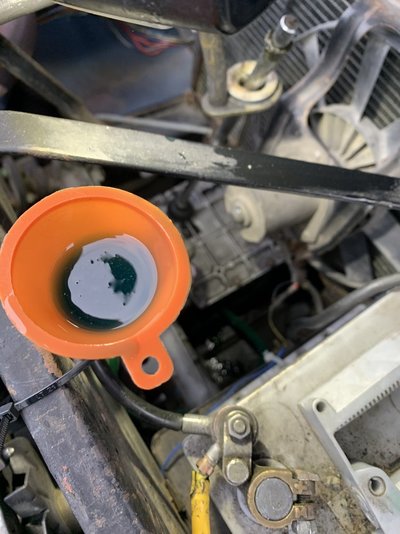

I went to Auchan and got it there for half price. . It was cold in the morning so the oil took ages to get in.
Top tip. I cable tied the top of the funnel to the cross member, so I didn’t have to hold it up all the time.9F85B602-6B98-4F38-B4C3-70C33594DE59.jpegC938A2E1-373B-4BFB-9E7D-F76AF6F3D342.jpegB986633D-EE74-4219-93C2-6F577A56C97E.jpegp9F85B602-6B98-4F38-B4C3-70C33594DE59.jpeg31414AF7-39F4-40C7-A0E3-898C5846C857.jpeg
