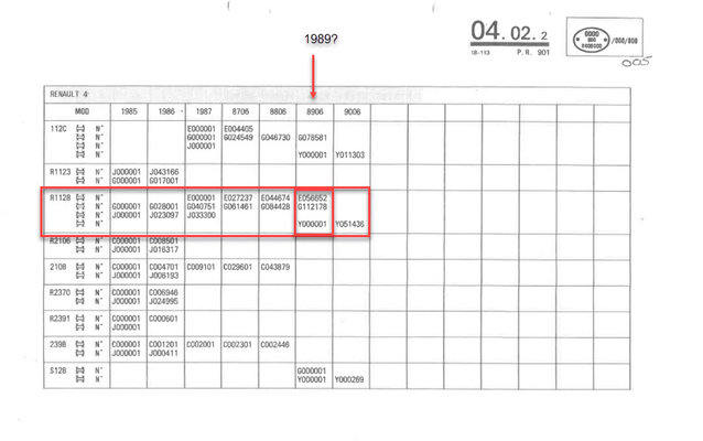

Not sure this will help but the pdf copy of genuine parts book has year of manufacture tied to first chassis number so if yours is lower than the 1990 listing it must be 1989
Brian Whiteside of renault classic car club will assist in these cases for club members
https://drive.google.com/file/d/0ByjyTYVWAjtQaFQtNkpDa0pPWVU/view?usp=drivesdk
Many Thanks for your link!
I've tried to track down my year but matching the VIN on page 5 of the PDF but it doens't match anything. My VIN is VF111280003153XXX. (I substituted the last 3 digits for an X as I'm not sure if its a good idea posting VIN online?). Looking at page 5, I have a R1112 but the serial numbers have a letter in them. My VIN only consists of numbers so it matches none in the diagram. Am i reading it the wrong way?

R1128 is what you are looking for. If the VIN contains the string "112800" then you have a 1108cc car dating after 1981. If you need help to get a proper identification you need not the VIN, but the vehicle number — which will be similar to that on the VIN but should contain additional digits. This number is found on a square plate on the bulkhead (under the bonnet).
There should be two long lines of numbers with Renault lozenges at each end. The second line should start with a letter prefix (in your case probably J, E or G) and the numbers after this are the vehicle serial number. This letter should also appear on the VIN so possibly you have mistranscribed it. With this information it should be no difficulty for Renault or a Classic-Car club to date your vehicle accurately. They will need a legible photo of the square plate.
These details come from the official Renault 4 Parts Book PR 1104 page 01.23 (paper version).
There is only one "real" book about the R4 which contains hard information rather than Gallic fluff, and that is Album Renault 4 by Robert Séjourné. This indicates that model year 1990 for the R1128 had a rearview mirror mounted on the right hand door as well as the normal LHD driver’s mirror. This might enable you to date the vehicle : but "model year", I believe, starts in the previous August (CHECK THIS INFORMATION with experts). So there would be no contradiction in your car being described as "1990" but in fact being manufactured in the previous year.
By the way — forgive my ignorance — why is 1990 so much more expensive of Import Duty than 1989?

Ah i see. Thanks for your help!
The problem is I don't have the car so I cant find the additional numbers under the bonnet.
Regarding your question, if a car is 30 years old i.e 1989, HMRC charge 5% VAT vs 20% VAT if the car is under 30 years old (1990 and beyond)..

The serial numbers on the Renault parts book always refer to the oval plate number, not the 17-digit VIN.

The plate is square on later models, not oval. My description referred to the similar plate on my own vehicle, which dates from 1985. Unfortunately these do not give the type (e.g. R1123, R1128) quite so prominently. But (i) when dating a car, the oval (square) plate is where to start, (ii) the VIN quoted by "bartoni179" looks as if it might not be quite correct as it doesn’t include a letter prefix. Again, I’m comparing the numbers on my square plate with the VIN shown on my vehicle Registraition Document (V5).
