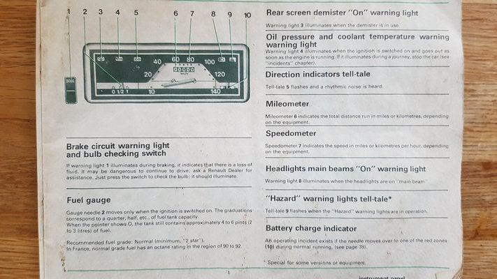

There should be a warning light on the dash:
I was with the car today (its in a friends garage) and tried the indicator. If you indicate right, no green light. If you indicate left however, it flashes on momentarily then goes off. I'm annoyed with myself now that I didnt check it with the hazards on. I did also notice that the rear RH indicator has a dud bulb in it. Still quite strange behaviour. I will take this sheet wirth me the next time and try out all the different lights. Another thing I noticed when driving it was that the speedo seems to work ok- well the needle is quite wobbly, but the mileometer (or the km equivalent) doesnt work. That said, the 10,000 dial just seems to go round all the time.
Very perplexing but I'm loving it!
Check first that all indilator lamps are good and flash, then if the problem is still present, change the flasher unit.
Odometer going wild is rather common on six digit Jaeger units. Easiest and cheapest fix is to fit a good secondhand instrument palnel.
