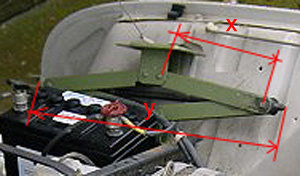

I´m lacking the original lever jack and there can´t by used any normal screw jack because of the unusually high lifting. So I decided make it myself. Some would measure the arm and the screw-bar lenght for me? A picture of the stool would be very appreciated. Many thanks.

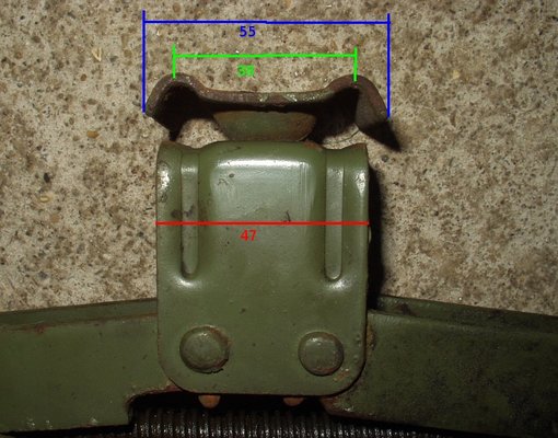

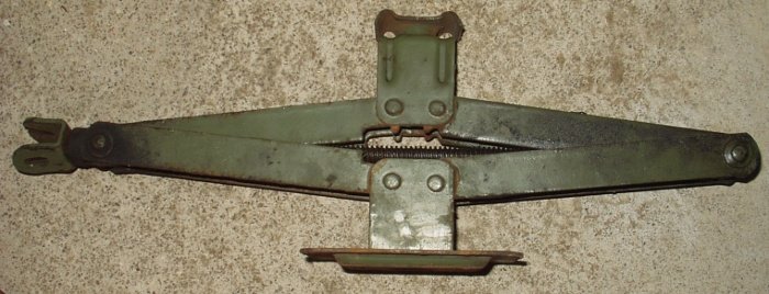

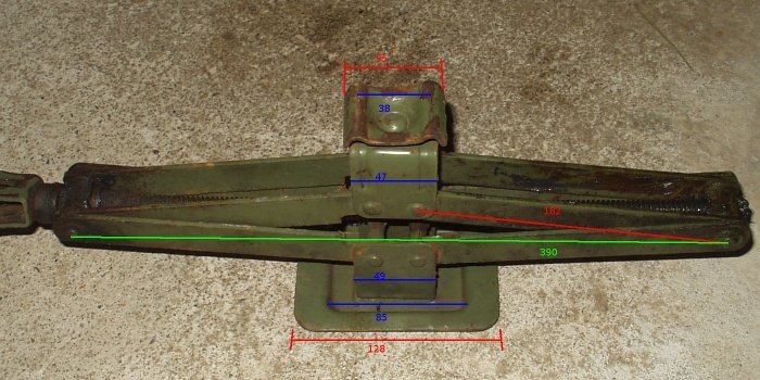

Hi Pavel, I will measure these for you. I will post those measurements here soon.
Hello again,
the dimensions (in mm) are marked on the attached photos.
The measurements not on the photos are:
the diameter of the hole in the base (25mm);
and the length of the shorter side of the base (95mm);
the length of the shorter side of the 'inner' part of the base (63mm).
Hope that helps!
Jonathan
