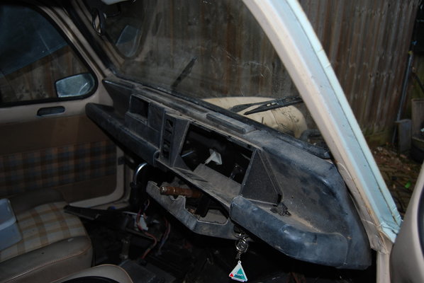

Hi everyone,
A further update on my progress towards my conversion from left to right hand drive.
The steering column.

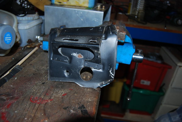

I started by cutting out the top steering mounting from my scrap RHD GTL.
Drilled out the spot welds, trimmed off the excess metal and aligned the pattern on my cars bulkhead, after removing the air vent.

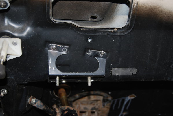

Temporarily fitted the mounting bracket in position.
Temporary fitted top section of the steering column.

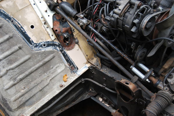

At his point, I noted that neither of the lower steering column sections were the correct length to attach to the steering rack.
One was way to short, the other way to long.

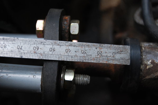

Looking at the left hand drive rack showed that the input flange was approx. 25mm from the body of the rack.
The right hand drive rack flange was very different at approx. 50mm from the rack body.
I have concluded that this is likely down to Renault using several suppliers for steering racks.
This was not going to be a straight forward right side for left side swop over.
Now I need a custom length lower steering section, but what length ?
First I loosely fitted the right hand drive dash board.
Where is the correct place for the column ?
First I aligned it with the old witness marks but I am still not sure that is 100% correct.
I have a reasonable gap between cowl and steering wheel.

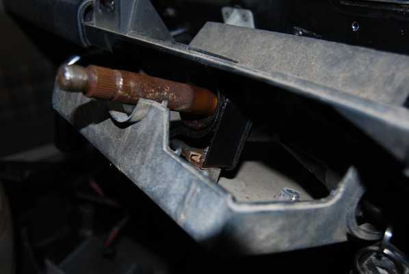

Then I thought about the indicator stalk. For the indicators to cancel automatically the steering wheel must be at the correct position to contact the trigger on the indicator switch.
This is the defining item.
I have fitted the indicator stalk and aligned the steering wheel to the stalk trigger.
However the indicators do not cancel because there is excessive play in the plastic trigger on the stalk.
Progress halted until a new indicator stalk arrives.
This photo shows both lower steering column sections, short one fitted to the car plus spacers and the long one resting along side.
I made up these tube spacers to find the correct increase in length I will need.
Currently, plus 57mm if the short lower section is lengthen.
My plan is to take the section to a local machine shop and ask them to do the modification for me.
Home welding a steering column is a no go for me.
That's it for now, cheers Dave.
