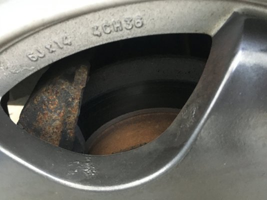

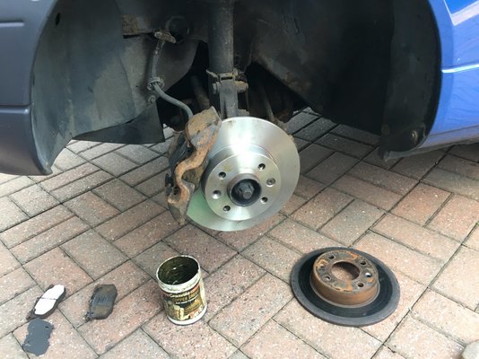

Twingo brakes update... everything good at the rear, front less so. Pads have plenty of material however the picture explains the reluctance to stop at speed.... if I can work out what of the many choices I need to order then that's the plan next. Frustratingly, I get discount at the local Renault dealer so normally go in there with the chassis number - but they're closed - so it might just have to be Mister Auto.

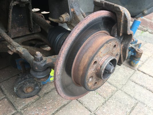

After a couple of days of doing other stuff - work and building a massive plastic shed mainly - I've had a look at sorting the Twingo brakes. With help of Mr Reno of this parish (thanks, Paul!) I've managed to get them ordered from Mister Auto so we'll hopefully have proper stopping ability later in the week!

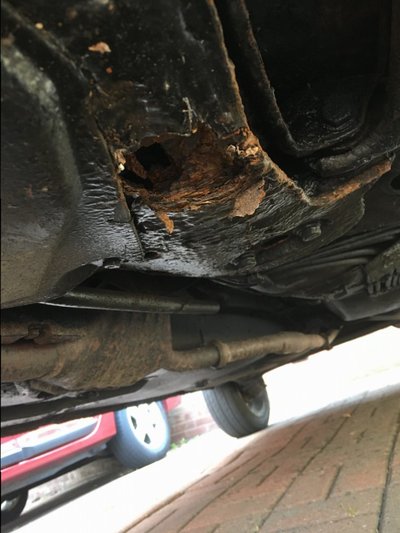

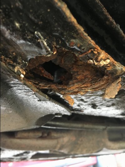

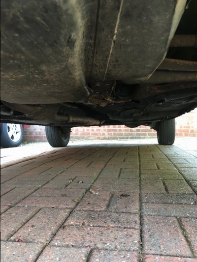

I'd planned, once I'd finished lounging around, to change the oil and filter on the Twingo.
I bought a couple of filters latest time I was in France and bought oil last week so we were all set. Out with the ramps, drive Twingo up, crawl under. And then it all went wrong.
Hey, that looks a bit crusty, I thought.
Prod.
Hmm, very crusty. Bother.
So what now? I really don't know. I'm not going to turn up a decent front subframe for it easily or cheaply and changing it would be the sort of Big Job that I really don't fancy and probably massively uneconomic to pay someone to do.
I think I'm going to sit outside and have a beer whilst I contemplate matters and (hopefully) await some helpful words of encouragement. I'm working tomorrow, was planning on using it. Rather think I might not now.

Heh, I think it might be a bit much for a bit of old tin, filler and underseal to sort. Not that I've ever done that sort of thing before anyway... :whistle:
The ever helpful Andrew McGraa tells me its not as big a job as I thought so if I can find a second hand subframe then we should be ok. Still going to miss most of the summer though, sadly. Might just run it up to my friendly local old car place in the next week or two, see what they reckon.
