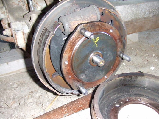

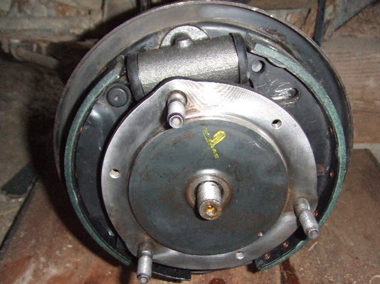

After struggling for a day, this morning I managed to borrow a drum puller from a neighbouring farmer. It came off in 2 minutes. I wish I had known before that he had one! The wheel turns very easily now that the brake shoes have been released.
I'd really like to expose the whole backplate and springs and shoes etc so I can give everything a good clean and rub on some copper grease before I replace the shoes.
Unfortunately I have no idea how to remove the hub so would welcome any advice.
The hub does not need to be removed in order to gain access to the brake shoes. You must remove them if you wish to clean the backplate itself.
If you are lucky, it will come off with a slide hammer (provided the driveshaft end is free to move in the hub splines, otherwise you have to remove the whole stub axle carrier and drive it out from behind, either be a special puller or by hitting it with a drift and hammer.

I think I'll just leave the hub on as I don't really have any major problems other than dirt.It sounds like a lot of work when I don't have all the correct tools.
I think the cylinder might have been leaking cos its like the inside of a chimney behind the hub-hopefully I can just scrape it off from the side. A fair bit of rust on the hub as well, that's why the drum was so badly stuck

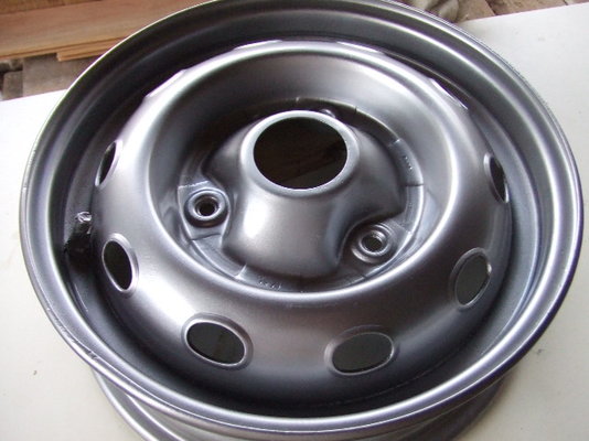

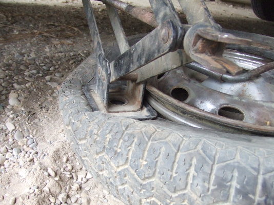

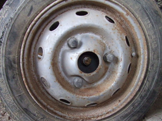

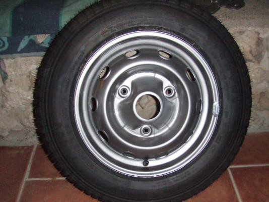

After getting the tyre off (Renault4 Discussion-removing tyres from rims) I sanded the rim really well! The back, inner and the outside and removed all the rust and pretty much all the paint as well.
After I sprayed the primer, I used a metallic silver grey and then the clear varnish. Apparently the metallic colours don't set without the clear coat.
I'm pretty pleased with the result and also pretty hooked on the smell of spray paint!!

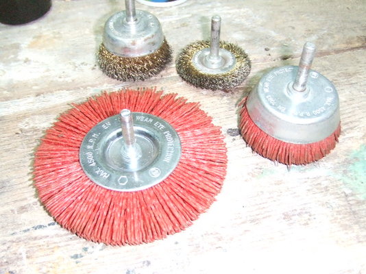

Ooh, that looks really nice now. How do you sand all the fiddly grooves? By hand or with some kind of power tool?
I have some really nice nylon brushes that I fit onto my drill. I usually use them to clean up old doors and Oak beams. They worked really well with the rust and the one on the left fits into the deep narrow grooves perfectly. There were a few spots at the bottom of the rim where the rust was really severe and its left a pitted surface. Used a wire brush for that and of course quite a bit of hand sanding

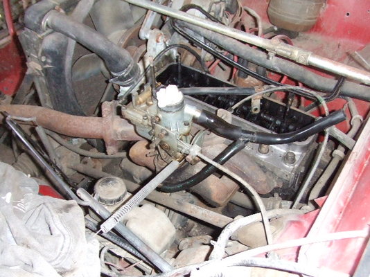

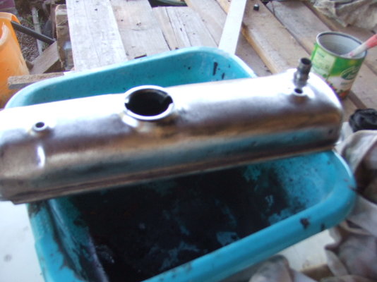

Opening the bonnet was depressing! It was so dusty, dirty and rusty so I'm spending a bit of time doing cosmetic repairs before I try and start the engine.

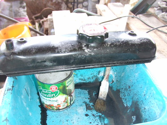

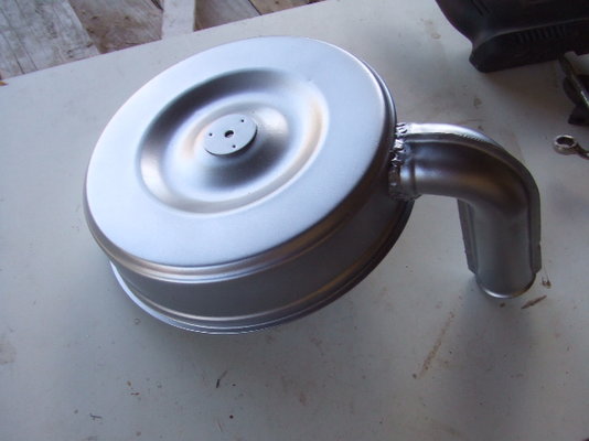

I've cleaned and sprayed the air filter cover and today I cleaned the rocker cover and rockers. The oil was black and thick!
Just one question about the exhaust manifolds and the exhaust pipes. They're very rusty but I can get most of the rust off and perhaps treat them with Kurust or the equivalent. Can they be painted? I have a spray paint that is marked 800 degrees Celsius.
I've uploaded a few photos, so you can see how dirty the engine compartment is
