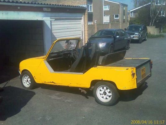

hi,i plan to put bigger tyres on my R4 F6,i have the 5.5 alpine turbo rims and spacers. are there some pictures of bigger tyres on a r4 ? or what is the max .i can get under the original wheel arches?

have got 185/60 13 yokohama on my yellow peril have had to gently tap upwards front edge of lower floor skin to stop tyre rubbing when driven hard 185/55 are fine 175/70 13 definitly no good unles you only drive in straight lines :(
