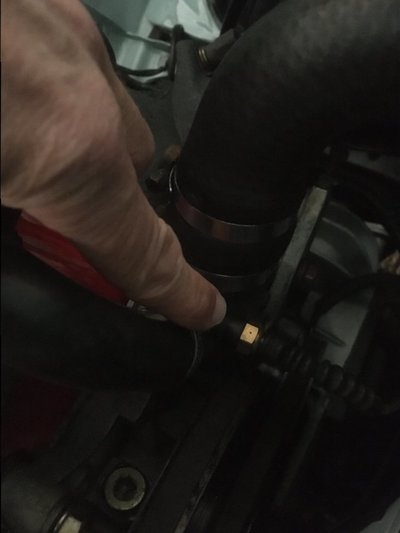

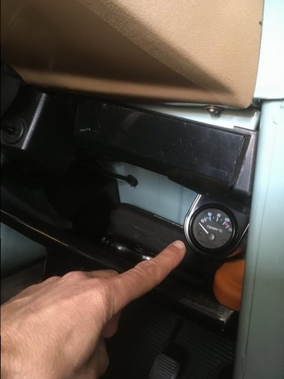

Hello everyone I agree with the comments above. And would suggest if you do decide to fit extra meters then a temperature gauge is only one. R4’s can suffer distortion to the engine head if they get too hot. So a temp gauge is a useful thing as the red light is often a ‘too late’ warning. I bought one very inexpensively from eBay. It’s under the dash and the sensor is literally pushed into a casting hole on the water pump. It’s very responsive there 9ADE0AE5-D537-4D64-8CF5-A69BE07118EC.jpegABD367E8-D18C-4285-9139-B493D24CF057.jpeg

Which way is which here and is it applicable to my '86 1108cc GTL? Thanks, Mark.
So Jonathan have I got this right, the temp sensor isn't actually in the coolant, it's just measuring the temp of the pump body? If that is the case it's far better to have a sensor screwed into the pump after removing the blanking plug, so properly record the temp of the coolant. If the pump hasn't got said available aperture the next best thing, although not ideal is a sensor fitted into the top hose. Kits are available for this.

If you fit an external ("contact" as often called) sensor on the blanking plate at the rear of the head you will be fine. The more "scientific" approach on this, that involves more work, is to remove the plate, drill it and weld a nut with suitable thread to accept an ordinary water temperature sensor.
It's a bit easier on the GTL, there is a plugged M18x150 thread at the front of the water pump to accept the sensor on other cars (R5 etc.) with a factory fitted temperature gauge that use the same pump.
Whatever you do, make sure the sensor matches the gauge you are going to use. Different brands of gauges have different operation resisances.
The arrow marks the spot aka the plug on the GTL pump
Not there JdeW, that's where the heating return pipe from the carburettor goes. The threaded hole for the temp sensor is on the front of the pump.

Actually guys I too thought the sensor needed to be directly in the flow. However the pump body is aluminium and transfers the heat very quickly. 0k it must be a little slower to respond but honestly it works great and I’m satisfied I can tell trend - ie if it were heading up to boil

How did you push the sensor into the pump ?Did you screw it in or used some kind of glue? Thinking of doing the same since my overheat paranoia kicked in...
