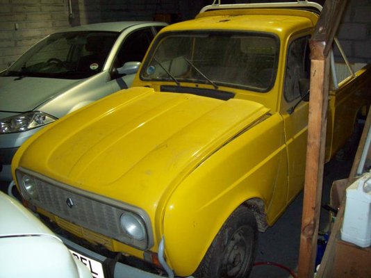

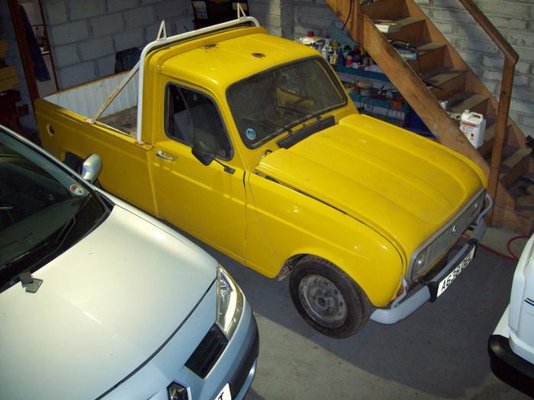

My R4 Pickup out of habination
renault4mad
497
Penzance

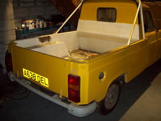

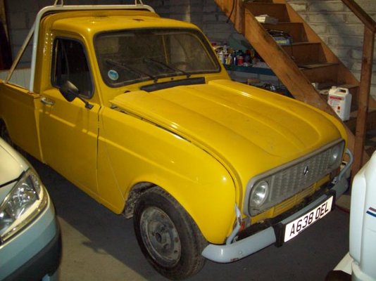

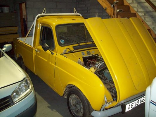

Its been in a container since early 2003 so i thought it was time for it to be reborn, rolled out loverly onto flatbed truck, one flat tyre in 8 years aint bad...one poor bit is the roof were the aerial is...someone put a rear 4 seat on there out of the way and forgot about the aerial (it is fairly dark in the container) which has now pulled the aerial through :eek: but should be fine..

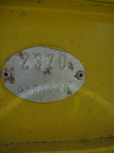

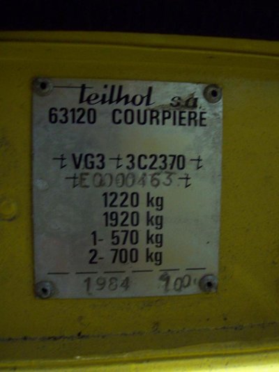

As you see from the chassias plates its a Teil Hol conversion....
Im going to get it painted in the old 80s Renault service colours to advertise my Renault garage...white top, black stripe...should look great...anyway heres the pictures

It's a beauty, well done. I have not had the pleasure of owning a pickup yet.
all the usual checks and cleaning carb etc, battery charged...new fuel in carb...(via can)...brummmmmm...yippee

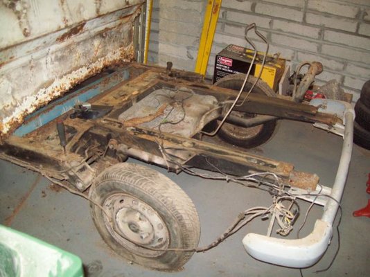

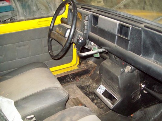

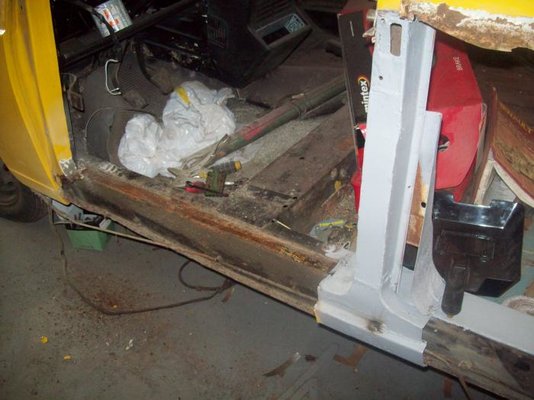

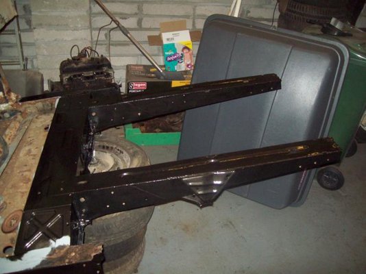

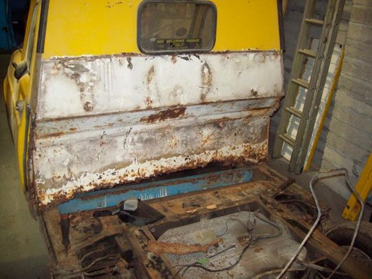

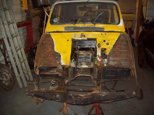

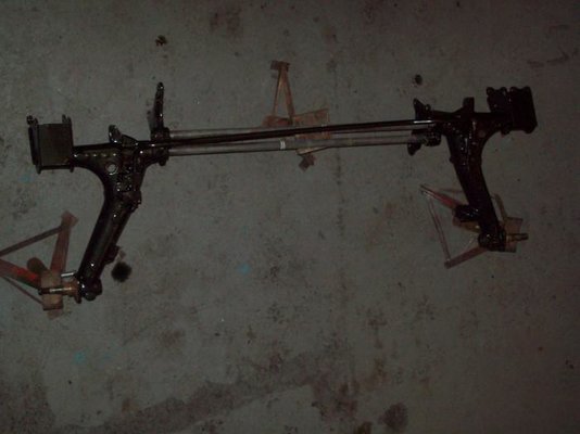

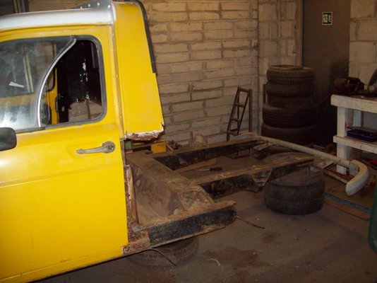

some upto date pictures of the resto...

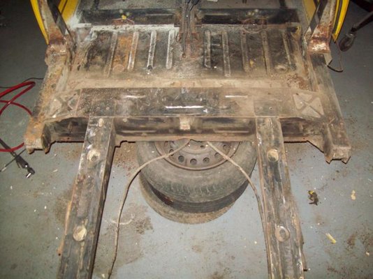

As you can see from the early complete pictures the back had been fibreglassed out but it had started to crack around the top edge. I wasnt happy with it so i ripped off all the fibreglass only to find chipboard under it and the inner wheel arches containing dryed/dust wood and fibreglass patches. Took that off and too my horror they had covered all the original rusty floor pan and inner wheel arches with all that. :mad::eek:.
Well i did have a panic thinking the chassias would have gone but after removing it all i found the chassias was perfect...not a mark on it.
This pickup was sold to a lady in 1999 for £3000 with all this covered up...shocking:eek:
Now the task of finding replacement panels for the rear end. Facebook the saviour...joined lots of 4 sites and asked around and after a day or so a chap contacted me from the 4-5-6-7 club in spain and told me about a company called 2CA (Concept Composites Auvergne) in Arlanc France. I emailed them and had a reply containing a catalog and price list for all the panels on the pickup.. AND they had them all in stock...:p wow...easy as that...
When Teilhol went bust in the 90s..they bought the stock..presses etc for the rodeos etc.
They done me a quote for the parts required including postage and VAT. (Great) 1261.00 EUROS delivered..:eek: 385 postage..206 vat was included in that mind.. so they will arrive next month when i sort out the money...
worth it i think...
thats enough of my waffling on...hope you like the pictures

I seem to remember I said something about just a few small jobs to do before the pick-up hits the road. Reckon that might have been the "kiss of death". I think I owe you some help if you need it pal!:smile:

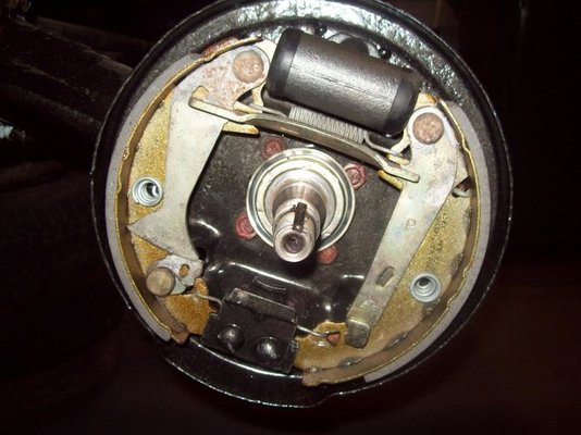

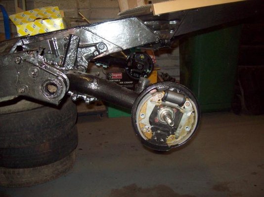

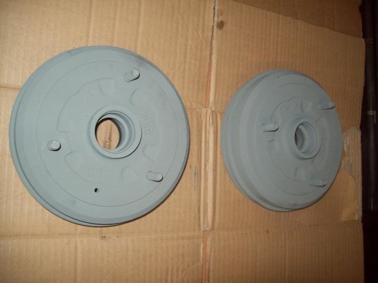

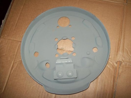

Back plates and drums sand blasted...new wheel cylindes and shoes plus spring kits plus new wheel bearings to go in....

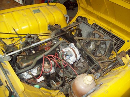

Engine out, inner wings off
if your gonna do job, then you got to do it properly:eek:
