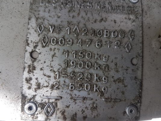

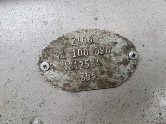

Hi Damian
There should be a couple of identification plates under the bonnet. If it's an 88, does the oval plate have 210B on it? If so, the production numbers are:
1987: C009101
8706 (From June?): C029601
8806: C043879
If it's a 239B:
1987: C002001
8706: C002301
8806: C002446
This page will help:
https://www.la4ldesylvie.fr/plaques-constructeurs-et-identification-des-renault-4

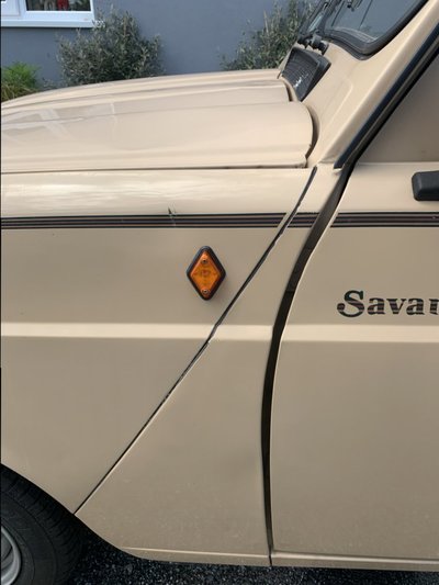

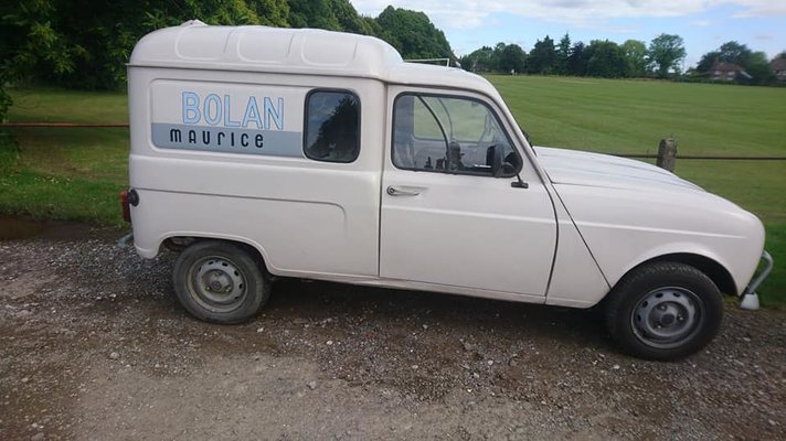

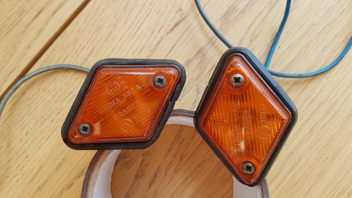

Hi there, nice van, welcome to the forum. I like the side window, very useful, and good safety feature.
The side repeaters as fitted by Renault to certain models including the 4, are diamond shaped to match the Renault badge, very stylish. Regards Brian. 20200615_170220.jpg
Hi Damian
1987: C009101
8806: C043879
If it's a 239B:
1987: C002001
8706: C002301
8806: C002446

Numbers for 2106:
1985: J000001
1986: J016317
I'll have a look for the side repeaters.
What's the number on the engine plate?

Interesting!
Numbers for 2106:
1985: J000001
1986: J016317
Thanks, Andy - so, if I'm reading it right - a 1986 manufacture. (with 1988 1st registration on v5).
The side repeaters as fitted by Renault to certain models including the 4, are diamond shaped to match the Renault badge, very stylish. Regards Brian. View attachment 26216
very nice they are too.

Amazingly, I've found a pair of working side repeaters! Will send a pm.

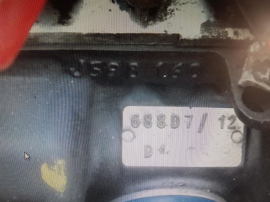

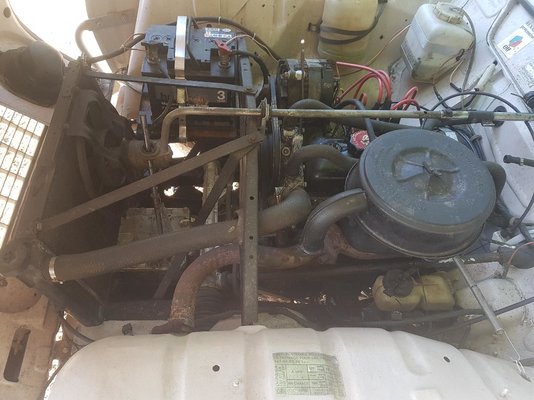

Any chance you could post a couple of pictures of the engine bay, including the engine plate number?
the engine plate number is all but dust, nothing left of it, ..
engine number listed as M598160 - DISCOVERY but a picture previously taken shows engine stamp J598160 and the old pic has the missing plate - attached -688D7/12 Dmissing plate.jpg

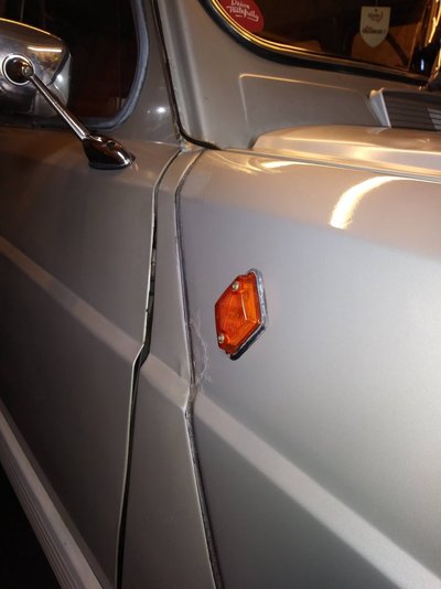

side repeaters they are great. I really didn't want to put any on, but those really are in keeping. grazzi
engine number listed as M598160 - DISCOVERY but a picture previously taken shows engine stamp J598160 and the old pic has the missing plate - attached -688D7/12 DView attachment 26223

If your van is an 1108cc (radiator immediately behind the grille, 3 fixing bolts on the starter motor), it'll be cheaper to get a new starter motor here:
https://www.mister-auto.co.uk/starter-motor/renault/4/4-112-1-1-34hp-1978-1990/
Okay, just seen the 688 plate - 1108 it is!
Eureka - solid evidence. and Thank you. so I now know confirmed engine size - is there a way to tell between the models - 1hp difference? wondering if that small difference means different parts?..checking Mr auto link
