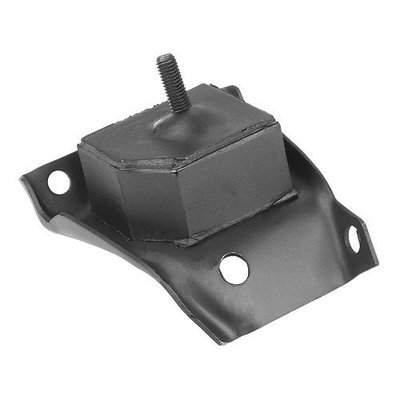

Unscrew single nut under rubber part of engine mount where it sits on chassis.
RUbber mount 4 bolts that are placed on engine block you can remove when engine is out of the car. And they are tricky to remove when engine is in carRT40414.jpg
