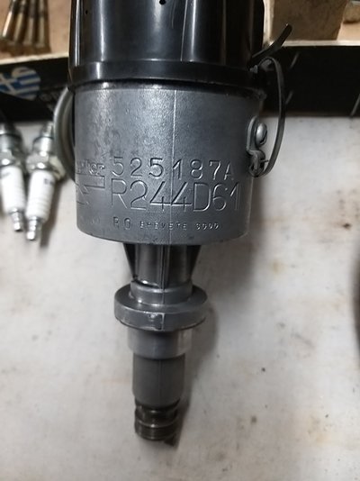

need identifying... Ducellier dizzies 525355B F3 (R309 D59) & Duc. 5 OR S 25352A K2

-have looked high&low to NO avail -anyone in the know?? Thanx Much in advance (1.st one Supposed to be for my spare R5A
(R1223) 1400cc. Non-turbo engine...) -Reid.

Hi there JdeW ! -Thanx much for info (LBC) -that is identical,and numbers correct as on mine.So it turnes out I'we got the wrong one for my engine.. I see and agree with what you're saying re the 123.

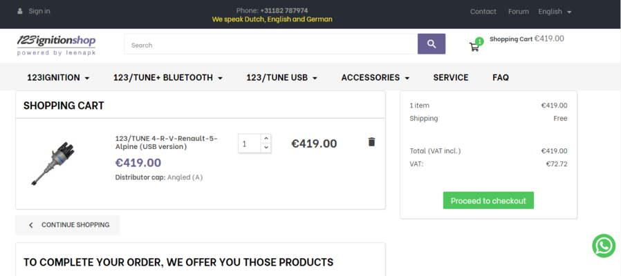

I took a look at https://www.123ignitionshop.com/ in Gouda and according to their webshop it should be available now
And yes unfortunatly original items are becoming rarer and rarer, but maybe the Marreau brothers might have a spare one ;)

Thanx ever so much guys!! Good to see 123 have come to their senses,so I'll give them a ring to order..

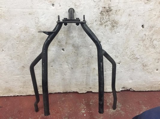

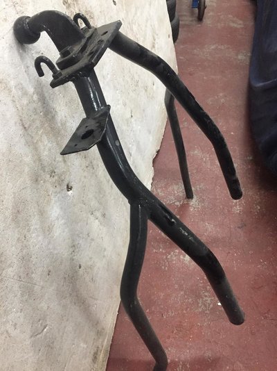

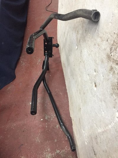

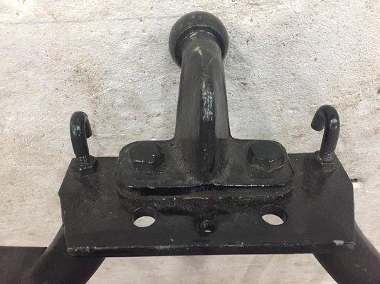

Hi Reid may be able to help on a couple of fronts. Firstly I am running the 123 in my 5g engined R4 and also in my 8g .I did see you at Thenay in 2017 send me an email address and I will send you my settings. Now secondly that elusive tow bar for a GTA V6 only 3 ever made by Alpine Dieppe take a look at the attached pics. Regards Simon

Your tow bar looks exactly like mine. IF the numbers I got at Alpine in Dieppe
years ago was/is correct we now just need to locate the 3rd one to start a club c",) (Hooked on Alpine?)
Did this one come your way via my old friend Alan Mathews (Alpine/Venturi/Helem) down Dorset ?
-Mine had a riveted-on ID-plate (black on silver) on it stating some weight-details/numbers I can't remember
