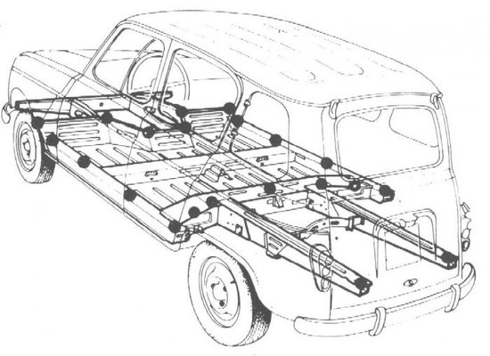

;) Hi, I'm sure you won't have any problem with your R4 after working on Land Rover... Removing the body is not very difficult, the body is attached to the chassis with 21 bolts (diam 7 mm):
First of all you have to disconnect all the mechanical equipements like wiring loom, sterring column, etc. Then, remove all the bolts, if you have an hoist, you attach it to the body and it's very easy:
I you don't have hoist you have to take a solid knife or anything similar and insert it between the body and the chassis to peel off the sealing, at the same time you put wood wedges to separate the body and the chassis...

Thank you for the great cut away diagram.

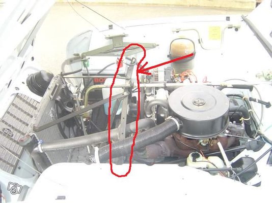

changing the 845 for a 1100 isn't difficult: only the engine mountings are different (even they look similar), another thing to do is fitting the GTL sleeper (not sure of this word, sorry !) under the bonnet and the 2 radiator mountings at the front of the chassis.

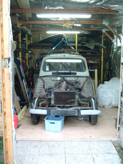

engine out this weekend

engine out
