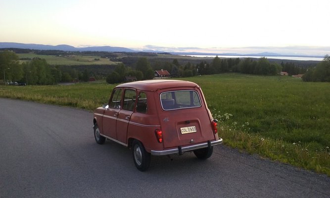

I just bought my 1963 r1123 about a month ago. Last weekend started a basic service, plugs, points..then I spent an hour going around the motor cussing feeling dumb not finding the oil filter. Contacted Renault guy here and he asked if my engine was 800-01. Yes. Then there's no oil filter. 800-02 there is an oil filter. By the way thanks for letting me join in. American living in Sweden. Always worked,renovated owned American or Swedish cars so this is a whole new adventure for me buying a Renault and my French is very limited ;) Hope to learn and restore my car.

Thank you! (Apologize for barging in on someone else's thread)
Bought mine for 12000krowns. Was another one, beautifully and completely restored for sale here, but then you don't learn anything or make any nice contacts with like minded people so what's the point in that..? Mine needs a lot of love but it's a long process and fun to have a project you can already drive as is.
