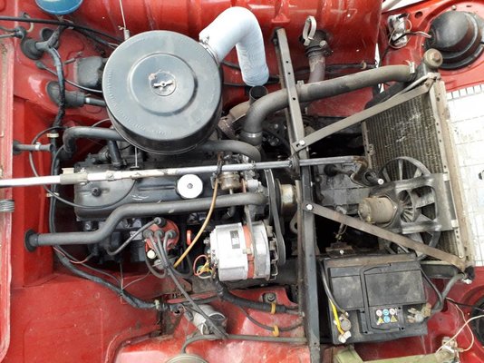

The earth strap from the gearbox to the battery should be a very thick wire that can carry a huge amperage. Some cars have a braided strip fitted.
Not sure if you can see it on the picture, but, this is how negative cable looks like.
Check that, when the problem exists, 12 volts are reaching to starter motor solenoid when you turn the key to "start" position. This is the thin wire of the starter. If not, problem is either ignition switch itself, or wiring to starter motor.
If you get 12V there, starter motor brushes are probably worn. Starter solenoid earths through one of them, so it won't be able to "click" even if it's good.
That negative wire looks too thin and (although it's difficult to be sure, because of the angle of the picture) not properly routed. It looks too close to the fan, but, as I say, that might be an optical illusion.
