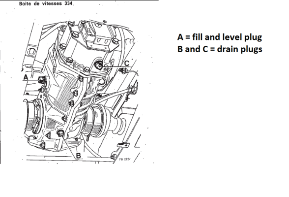

Hi .
Can anyone advise on gearbox oil change please . I tried on you tube but without any look . Does the bash plate need to be removed and which bolts/screws/plugs should be used .
Thanks in anticipation .
852
Cheltenham
#5
If you have the 354 gearbox, there's just one drain plug to undo. It's much better if you use a spanner like this (you'll ruin the plug otherwise):
https://www.ebay.co.uk/itm/Laser-To...506670&hash=item2a6de4fa0f:g:TwcAAOSwIgNXpLnR
The refill plug (same size) is on the side of the box. I find it easiest to refill the box from underneath (after removing the undertray), squeezing the oil in from one of those containers with a flexible spout. When the oil runs out of the hole on the side, the box is full.
This may help:
https://www.la4ldesylvie.fr/index.p...e-de-vitesse-type-354-hao&catid=20&Itemid=242
It shows how to fill the gearbox from above.
