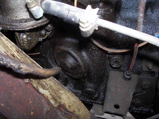

Gerrie, on the position Malcolm described you should see a round cap fixed with a hexagon bolt (19mm?). This is to be removed and a filter fitted instead, provided a threaded pipe is fitted on the bolt position. They used to be obtainable, but now they are hard to find. It's very easy to make at a machinist shop, though, if you show him the bolt to determine the correct thread.

No I mean this one, it's an oil filter compatible block, but no one has fitted a filter yet (since 1971!)

Hi Angel! I see what you mean, thanks very much for posting the pic. I have a timing chain car (about Sept '67, full width grille) and it definitely doesn't have that.
I suspect this started happening when the Canadian market started leading the push for oil filters and to accomodate it they started putting the fitting on all production but Renault just didn't fit the filter in other countries because there was no real demand????
I've heard of mods to put filters on earlier cars- apparantly Renault used to sell a factory kit to put a remote oil filter on Dauphines in the US, and there was a web post somewhere about a Rhodesian doing it on a 4 for racing, it would be a nice thing to do, but changing the oil more often seems to work too.
