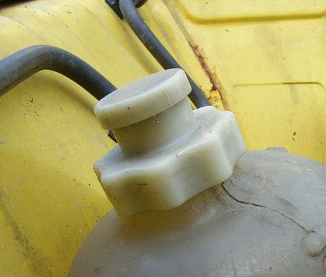

Well Isabelle has made it as far as turkey on the rally but were having some overheating issues i hope you can help with.

5. i read on here that the cooling system should be pressurised to stop it boiling - our expansion bottle has a small hole in the top so i guess it cant be pressurised!!!

- Whats the hole in the bottle all about?! was it a safety valve that has gone when under too much pressure? Should i be able to bung it somehow? does this sound like the problem?

I'm no expert, but there should not be a hole in the expansion bottle cap, otherwise it cannot be pressurised to prevent boiling at temperatures over 100 degrees Celsius. Expansion bottle caps are designed to release at a certain pressure as a safety measure. So bunging it would, I think, solve your problem, but if your expansion cap doesn't have the ability to release very high pressures, then it would be dangerous. I'd suggest finding the correct cap from a garage, if you can.

If the system isn't pressurising there lies the problem - water boils maybe 110C when it's pressurised, and the fan doesn't come on until after a non-pressurised system has boiled.
Here's what the expansion bottle cap should look like:
Should be a rubber seal under the cap. It has a pressure relief valve that that opens when the pressure gets too high to stop the hoses and radiator from bursting, so blocking up completely is probably not an option.
Maybe you can find an expansion bottle from a modern car in a scrapyard?
For filling the system be sure to fill from the radiator first, replace the cap, fill the expansion bottle and hold it above the car. Then turn the heater on full and undo the little valve sticking out of the bulkhead, and wait for water to come out. Then quickly squeeze and release the top hose until it feels like there's no air left in there. Check the expansion bottle level and done.
So, I'd fix the trouble with another cap if you can find a Renault dealer, or an expansion bottle from a scrappy. Temp switch is probably OK, and having the fan on constantly shouldn't do any harm. Try not to keep going for too long with it boiling - head gasket won't like it.

we forced the fan on and blocked the hole with a nail just to get us through the day, we'll try and source a new cap or bottle asap. No small renaults (4s, 5s, or clios) that ive seen here in turkey so replacement cap might be difficult, but there are a lot of renault garages so will see.

This expansion bottle cap is common on many 80s-90s Renaults, I think you will find one easily as Renaults are very common in Turkey, there is a factory too.
The hole is a check valve for venting when there is a need to draw air from the outside due to coolant expansion/contraction e.g. when overheated, then left to cool down. If it was not vented then a strong vacuum would be created that would tend to make the hoses collapse.
Anyway, if in doubt, replace the cap.

yes renaults were very comman in turkey (mostly 12s) and we pulled up at a garage pointed that the cap and the guy came out with a new one in about 60 seconds, we couldnt believe how easy it was!
