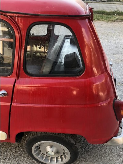

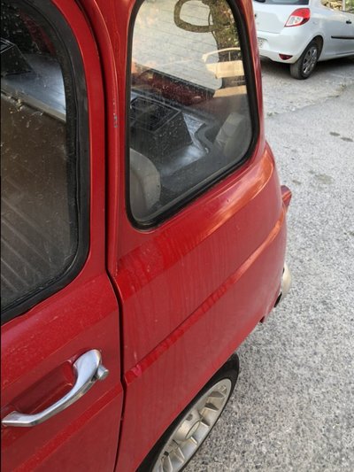

Grenuj Enthusiast Messages 206 Location Ulcinj Sep 14, 2020 #1 it spilled on my R brake fluid.. totally mess!!! I didn't have the strength this morning to make photo.. the color spilled out. I report a condition when it dries...
Grenuj Enthusiast Messages 206 Location Ulcinj Sep 14, 2020 #2 it hasn't dried yet... any recommendations? IMG_9795.JPG 135.4 KB · Views: 9 IMG_9796.JPG 138.4 KB · Views: 8
harbourseal Renault R4 Lunatic Messages 1,049 Location Breda The Netherlands Sep 16, 2020 #3 That is nasty. Have you tried to rinse it off with water? after that sanding and re-paint
petak Enthusiast Messages 1,906 Location Vodice, Croatia Sep 17, 2020 #4 If you do not clean it eventually will eat up all paint and make rust holes. But definitely you will need to repaint that surfaces, after you clean it. Sorry!
Grenuj Enthusiast Messages 206 Location Ulcinj Sep 17, 2020 #5 I didn't clean.. ok, today I will. painting .. no other option.
