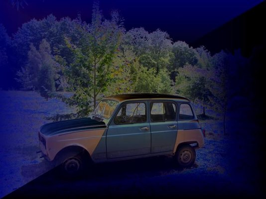

Well today I have mostly been stripping the engine and gearbox out of BB in readiness for its new heart!
I had just got it up on axle stands in readiness for its waxoyling and I happened to check the oil and found I actually had a lovely mayonaisse instead.
So I'm swapping the engine and gearbox from the white car into this one, the bonuses are that the white cars engine has only done 70,000 miles and the clutch is sweet on that engine whereas BB's clutch is oil contaminated, which is the other main issue BB leaks oil like a seive and there's oil everywhere!
So all in all its a fair job to swap them over but the gains will outweigh the time involved.

Erm it must be nearly £100 now!
Its only a bit of fun I've not spent that much time on the poor thing (am far too busy really but love having something to tinker with)
I was going to get it all looking really smart, but decided to F that and just get it on the road and enjoy it!
Beagle I'll have a look at the back of the car tomorrow, I think there may be one left but I know one was smashed when it had its accident, it was ramed from behind into the car in front so is quite badly damaged at each end.
