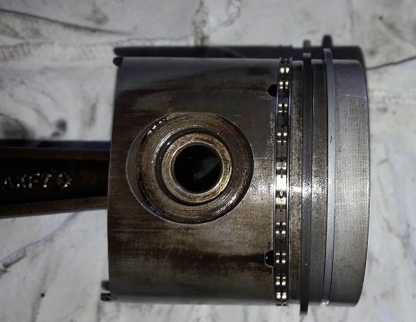

Hi all, as no one is making pistons & chemises kits for my car anymore (782cm2 839 engine) so I'm going to replace the rings, saw these on Lebon, my engine is a 1126 but these Goetze ones look v different to the original ones, they have a spring thingy on the middle & oil rings...anyone have any experience of them? cheers

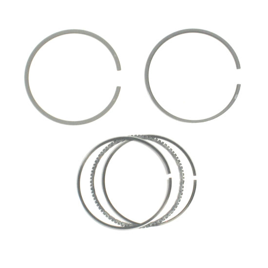

There a 3 piston rings per piston, from top to bottom 1,75 mm, 2 mm and 3,5 mm for the 839 engine with 55,8 mm pistons.
The top 2 rings are compression rings, the bottom ring is an oil lubricating and scraper ring and may consist out of 3 parts
New rings can slightly differ from the old original ones, especialy the scraper ring may differ, the 2 top rings are straight forward but differ in thickness..
Remove the old rings, clean any carbon residu and place carefully the new rings starting from bottom to top, so first the bottom scraper ring, then the middle (2 mm) and finally the top ring (1,75 mm).
The pistonring opening shouldn't be in one line but positioned at a 120 degrees interval.

Especially regarding the oil control rings, each manufacturer has its own way of building it, and there are one-piece rings, three-piece rings, one piece with expander etc. As long as the fitted width and diameter are OK, don't worry about the rest.
Goetze, in particular, is top-notch when it comes to piston rings and far better choice than the no-name stuff sold by "well-known" R4 parts suppliers.
