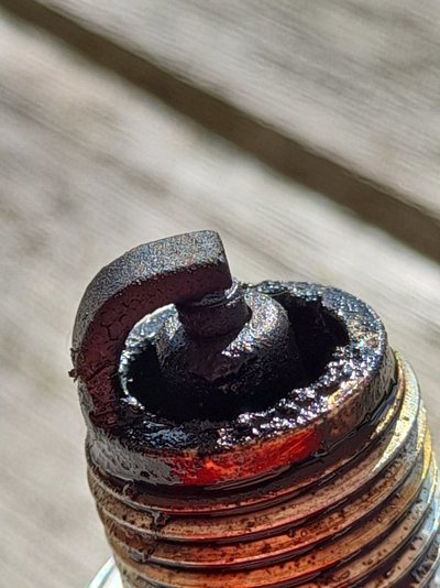

All plugs look like this.
Was worried it was piston ring leaking ... but can't be that suddenly on all four cylinders. Also note that electrodes aren't wet.
Must be mixture too rich no?

Fit a new spark plug and then see if there's a spark. Now do the same to all the leads and confirm the new spark plug produces a spark when connected to all four leads. If so, your leads are good and your plugs will need cleaning or changing. As to the colour of the old plugs, it looks like the mixture's too rich.
