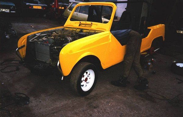

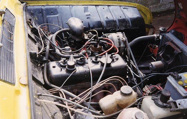

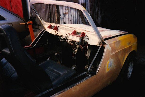

hi ivvan
good luck with project , i did try and fit 18 turbo engine to my toy after originally fitting R16 tx engine to 1300 4sp 5 gearbox
much measuring and trial fittingmeant the water pump was hitting body also problems with steering colum and manifolds
may be ok with lhd ?
ended up reusing 1647engine , renault 20 tl bell housing and input shaft , 5 gordini/alpine box
had to cut bulkhead and floor /chassis out as 1600 block is longer
few pics incase you havent seen my car these are old ones from about 1993
now back in use when its not raining :(,
more pics/ info on request
paul
