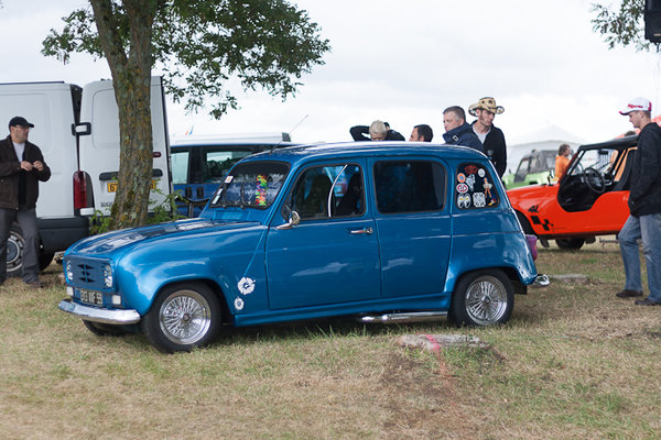

I saw that blue R4 at Thenay last year. The wheels do look pretty good, even if they're not genuine wires. With the lowered body, skirts, flared arches and smoothed boot, it's definitely a vehicle for cruising round town not playing in the mud like I like :)
Edit: And a customised grille too. I think this photo must be later as dual chrome exhausts and a few stickers seem to have been added.
Yes..you are right, the pictures I showed from Jimmy Popek's Blue R4 ( the guy with the cowboyhat) are taken earlier and I also saw/talk to him in Thenay.
The wheels are not such a bad substitution, concidering the price and these ones are Mangels custom made in the 80th.
BTW,I myself donot like the visable dual chrome exhaust for a R4, that's why I have had built my exhaust underneath,on the site, like most of the R4 have
