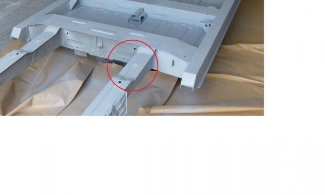

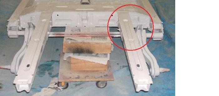

:confused: :confused: Hi all,
for many years I wonder why R4 have two differents chassis, at the rear of the chassis the design is sometimes different. Is anybody knows what is the models which have the one or the other of these chassis ???
It depends on year as well as the country of manufacture.
For cars made in France I think the change from recessed chassis rails to straight ones was in the 1970s. I don't know which year, but it would have been after 1973. I guess the change was around 1975.
For cars made in Spain the recessed chassis rails were still in production in 1984. French cars had the straight rails before 1983.
I don't know why they ever had the recessed chassis rails. They are interchangeable. An early body can be fitted on a later chassis if you remove the metal under the luggage compartment floor designed to meet up with the earlier rear chassis rails.
