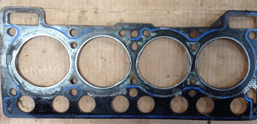

Today I started to replace cylinder head gasket on my 1991 Savanne which I understand has a 950 engine.
However the gasket set from Franzose is different to the one fitted. The original has slightly oval 72 x74 MM
holes for the pistons, which Franzose tell me are usually fitted to the large 1100 engine.
Can anyone enlighten me which engine I should have.
The car has only covered 62 Kl and I assume it is all original and correct.
Did they produce late Savannes with 1100 cc engines?

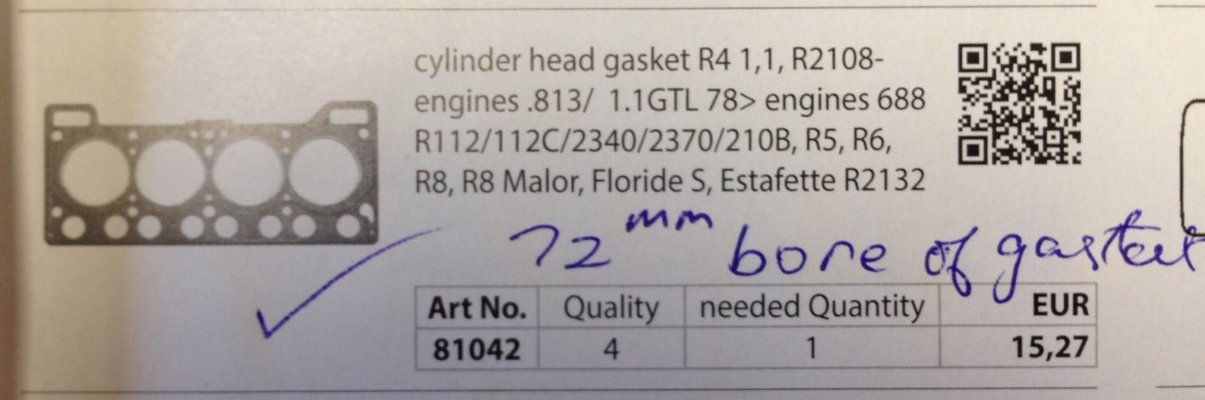

Engine no's C1C C7/08....... C130975 which makes it 950 cc. This is the old gasket and the suggested Franzose replacement part number is......81042(but I'm unable for some reason to load picture of it.) It is clear that the piston holes are oval 72 X 74 MM.
The Franzose catalogue states that 81042 is for 1100 R4 engines.
But the replacement is on its way so we will know next week if it's correct.
Not many cic engines in uk
But from what I remember same gasket as 1108 C1E
You could check original renault number on the online parts Web page I posted last week
