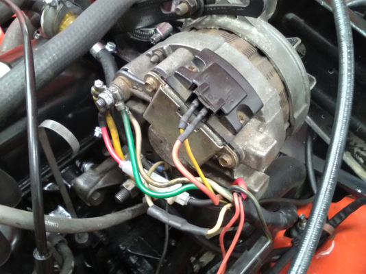

Pete Isom Enthusiast Messages 224 Location Raunds, Northamptonshire Oct 2, 2019 #24 My Restoration is nearly finished, But I cannot find a replacement alternator, its marked Ducellier 514012b anyone got one or know an alternative?
mr-reno-139 AKA Paul Cunningham Messages 2,274 Location lancing west sussex england Oct 2, 2019 #25 What year car is it send me a picture of the alternator as as I would recognise it by sight not part number
Andy McGhee Enthusiast Messages 1,849 Location Cheltenham Oct 2, 2019 #26 Pete These pages will give you some equivalents: https://www.oscaro.com/alternateur-valeo-433446-613842-4-p https://www.yoyopart.com/oem/3986630/lucaselectrical-lra447.html
Pete Isom Enthusiast Messages 224 Location Raunds, Northamptonshire Oct 3, 2019 #27 hey 1985 ish alternator.png 2.5 MB · Views: 3
Pete Isom Enthusiast Messages 224 Location Raunds, Northamptonshire Oct 3, 2019 #28 I was Told LRA286 but the builders dont think thats correct
